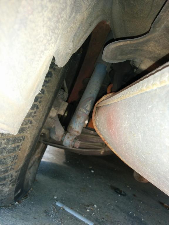

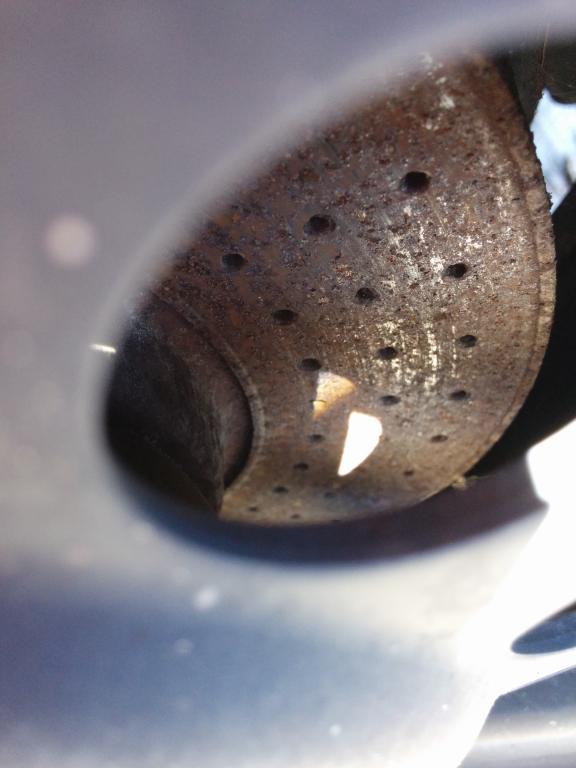

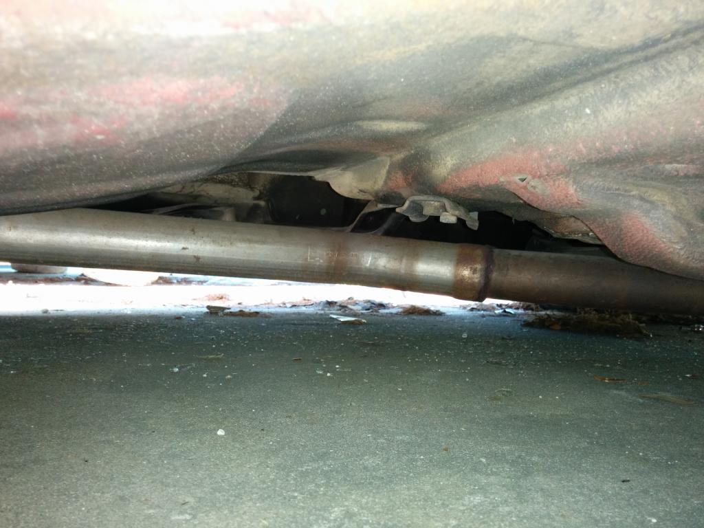

      Got a new starter Car cranks now old starter was hanging on by one bolt! Still need fuel pump.I found some surprises on this car too. A nice looking exhaust some tokico shocks and drilled rotors. Maybe this thing is already lowered less parts to buy!!!
