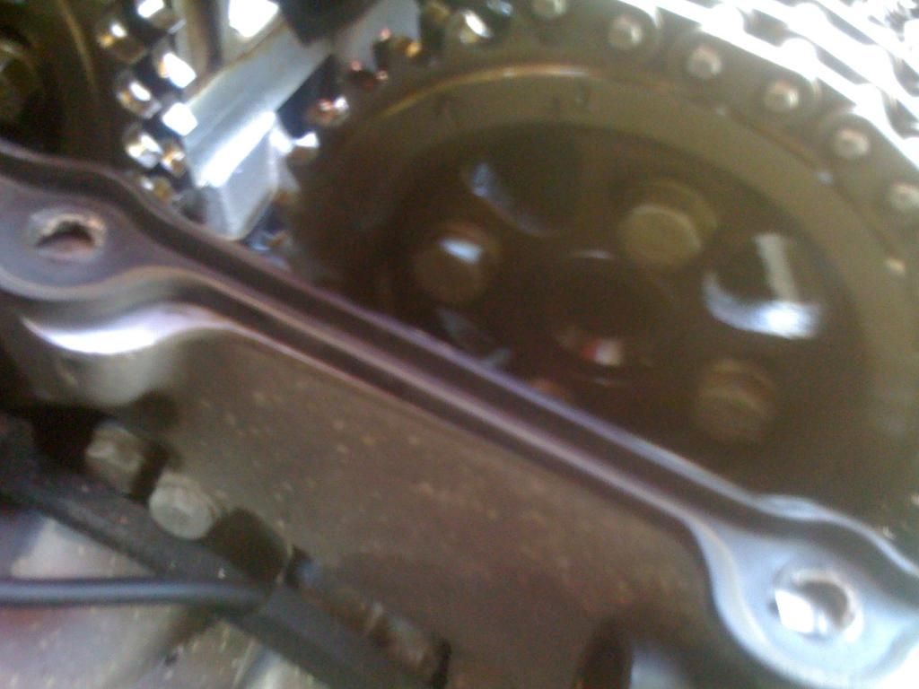

            I just went trough the other tensioner thread and i found out that my old tensioner was in the locked-up-super-extended position. Maybe the new one doesn't go that far out.
            Anyways, i took the valve cover off and ,no surprise, the teeth are sharp. The chain seems good. Both the adjustable gears were off a few degrees, maybe they weren't properly tightened last time round? (sorry for shitty pics)
            My oil is fresh castrol gtx 10w40.
            So i am at least looking for a timing rebuild... Head is clean tho.

              Hmmm, yeah if the old one was stuck in the past-max position then there is probably a lot of wear on all the guides. Your old tensioner...was it the original one / old design? If so, then I bet all of your guides are original too, and in need of replacement at some point.

                Just took a look at my old tensioner and it was indeed the old style. Kinda makes sense, my car has around 130k miles. The old tensioner's spring is pretty stiff still.
                So i should replace at least the guides and the gears. At 130k the chain is still probably good i guess.
