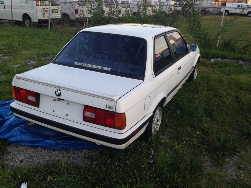

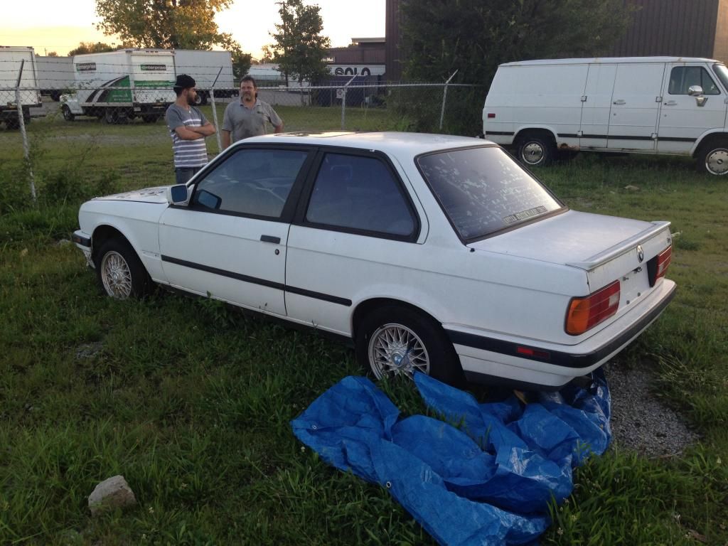

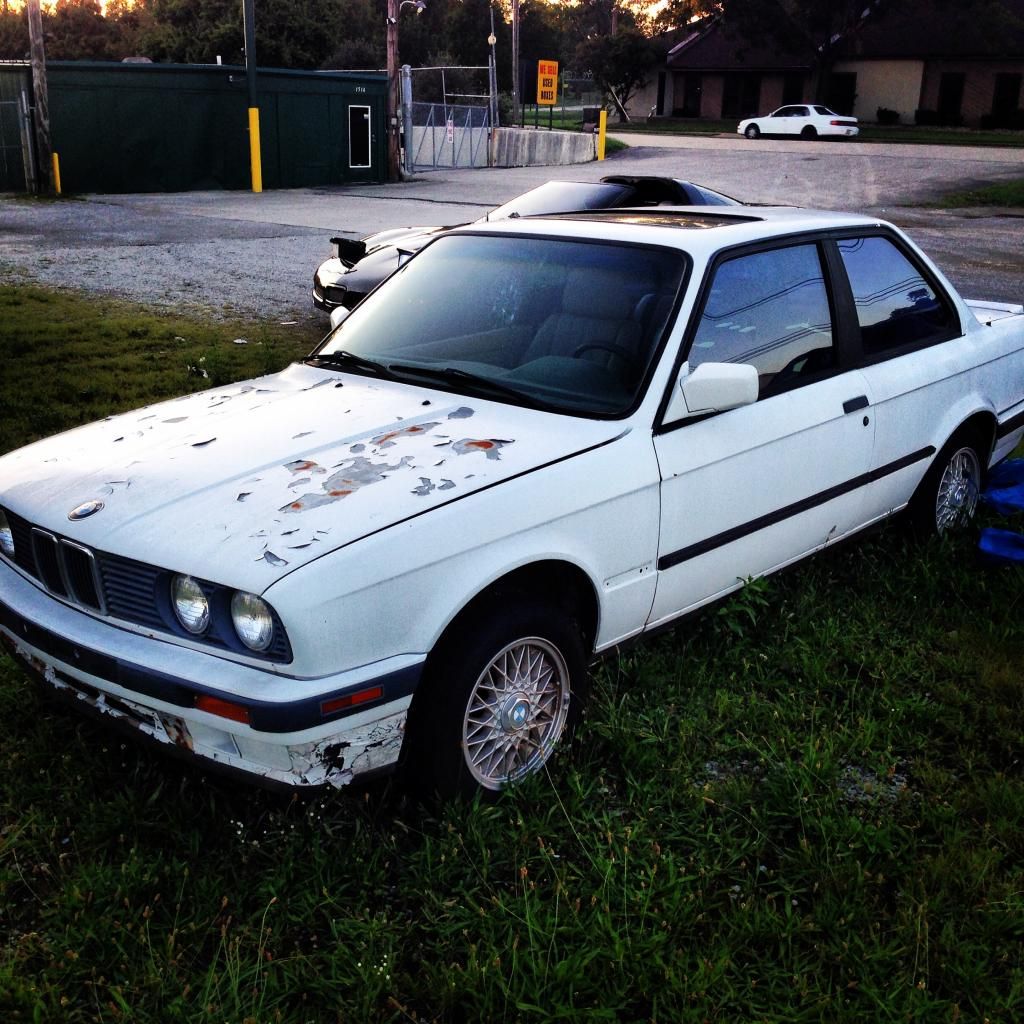

    first off i want to let everyone know I'm new to the e30 forums. i just purchased a 1991 318is from an old lady that had it sitting behind her house since 2004.
    apparently her son left it before going back to school and hasn't touched it since..surprisingly theres no rust that i can see and the interior is very nice..anyway, my problem is that the motor is the original 4cyl m42 , but when i popped the hood the intake manifold has been off all this time as well as the radiator and a few other things and theres spider webs and who knows what else inside the engine bay and more then likely inside the motor?.. i ended up opening the trunk to find a brand new still sealed head gasket replacement kit as well as the manifold and radiator and everything that was missing...
    my question is what would be the best thing to do to clean or check this motor to see if its even worth keeping or should i just go about with a motor swap and the headaches and deep pockets tha come along with it..
    i originally planned on just repainting and swapping the motor but over the past 3 days I've been in circles as to wether m30b35 swaps or s50 swaps where better and its a never ending debate.. any body have a lil advice for the noob i have funds to cover it but I'm stuck thinking wether its practical to dump 8-10k into a 800 dollar car i bought.. thanks guys and sorry for running on
