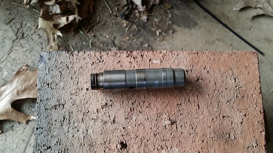

    My car sounds awful up front, I ruled out any accessories by removing the belts and firing it up, so I ordered a new timing chain tensioner figuring that's probably what it is. I just pulled out the old one and it was a bitch, I had to use vice grips to wiggle it out. Once it was out I couldn't get it to move at all, as you can see in the picture that's how far out it is and is stuck solid where it's at. My question is, isn't the piston thing suppose to stick out further and its junk right?
    It's got a measurement that it is supposed to have fully extended. I know the Haynes manual has the measurement in it. FWIW: The old style piston was replaced by the M44 version which is compatible with the E30 M42 engine. That looks like the old style to me so it was probably due to be replaced anyhow.
    Parts Collector and Former Houndstooth interior junkie.
      Thanks, I ordered one from Turner motorsport and it said it fit the m42 and m44 so I'm guessing it's the new style, and I looked all over for the measurement and couldn't find it so I'll keep looking, basically just to see how far off it is
        Yeah, I would throw that old one out.
          I just changed mine out with one from Turner as well. Made 150% difference in my engine. It sounds so nice even with cold starts now.
          You will be thrilled. I'll be changing mine as a maintaince item now every 30k miles.
            Just got done changing the tensioner and wow did it make a huge difference. All the noise and racket is completely gone now. I even thought i had an exhaust leak it sounded so bad but now it sounds like a new engine.
