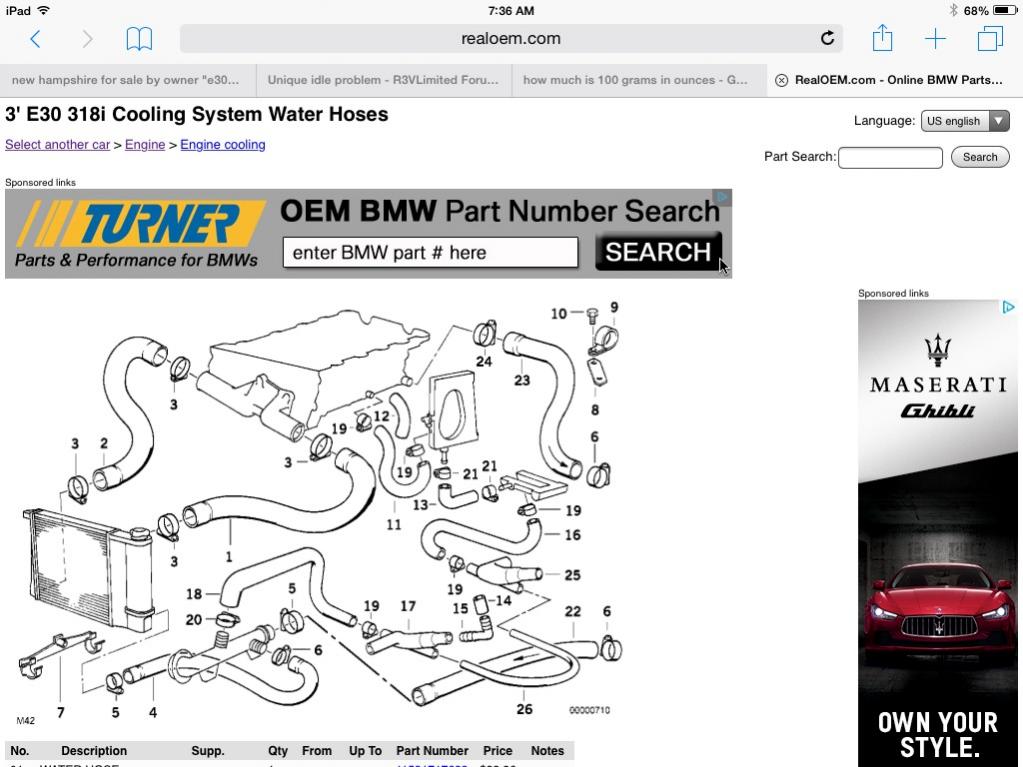

          I don't know if this helps but my car did something similar on cold starting. Typically it would stall a few times till it was warmed up (pretty embarrassing stalling ten feet after fueling up). I did the mess under the hood, o2 and icv cleaning. Nothing worked. Then my starter quit and I took my intake off to find one of the coolant lines had a hole and that's what killed my starter but I also noticed a hole in the hose that goes to the fuel pressure regulator to the back of the throttle body. One simple hose caused many embarrassing moments.
            Those were vacuum hoses, not coolant hoses for those reading in future.
            • Bimmerbum318
              • Mar 2014
              • 10
              No it was a coolant hose. I know there is vacuum hoses but there are coolant hoses as well as you can see in the diagram. My hose was I believe 18 and in the diy write up they said to just turn the hose to where 11 goes onto the block. Needless to say it was to much stress for a 25 year old hose. Nevertheless all I was trying to say is how easily things get over looked and my problem happened to be the hose on the bottom left of the throttle body to the front of the fuel rail.
