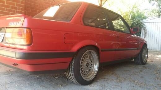

    I have the chance to purchase a e30 318is with 220,000 kms and a fully reconditioned engine with roughly 40,000 kms on it. My dad would be giving me a small loan to help me out, but he's pretty skeptical about reconditioned engines because he's had trouble in the past. Just wondering what are the potential issues that could go wrong with it being reconditioned? Also the car would cost me $7500-8k (Australian), is that a fair price?

      Thanks for the reply man, you can't really tell from the pictures but the cars paint is faded and would require a closed door respray respray, the engine was completely rebuilt and receipts are provided, I haven't found any rust in the usual places, battery tray, bell towers, rear arches. Interior is in mint condition, no tears, crack free dash. Considering the market and with only 3 318is's for sale in Australia, I feel like 7.5k would be a fair price.

          decent price if it's in good condition and they are legit BBS wheels
