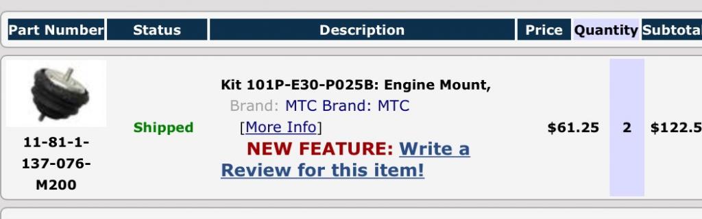

    I just installed new mounts from pelican parts 2 days ago. They were oem replacement mounts, looked exactly like the oem.
    As soon as I started the car I noticed something was different, just not the "different" I was expecting.
    The car vibrates loudly at about 1,000 to 2,000 rpm, so not at idle and not at cruising, which is ok for now but really want this fixed.
    Is there a break in period for these rubber mounts? So far I've put about 100 miles on them but very little if any improvement.
    Any insight is greatly appreciated!
    Below is a picture of what I ordered, I confirmed the p/n with realoem.

        MTC rubber components are known for their high-quality and durability (I'm being sarcastic, I've personally had a number of parts fail and no longer offer any to customers as dealing with returns on a failed part is aggravating).

          I called pelican and was told the mtc was the same rubber as OEM so there shouldnt be any issue with MTC. Regardless I still went ahead and ordered the genuine bmw parts ($180??)

            With all due respect to the guys at pelican, it is no where near true (perhaps they were reading a description or telling you what their boss told you, so don't hold it against them). MTC has never been an oem supplier (nor have they been using the same "factory" as BMW's oem suppliers on rubber parts).
            if you went with "genuine bmw" then great! If your problem persists at least you know it's not due to the mounts themselves.

                          Stock factory M42 engine mounts are liquid filled, as far as I know MTC and other less expensive replacement mounts are solid rubber and will vibrate.
                          If you can live it, there is nothing wrong with them.
                            Correct. This is why the OEM fluid-filled mounts cost much more. They're worth it.

                              That's interesting because the OEM mount I received look exactly like the aftermarket.
