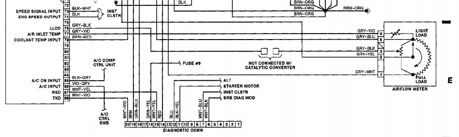

    My vehicle is a non-cat version and when the receptacle is disconnected the idle goes to crap. When I set the scanner up for the "cat version" and look at the engine data, reference voltage for the O2 sensor is present.
    It appears to me the ECU is set up for both cat and non-cat applications and the connector is sort of a "switch" if you will.
    EDIT: The eprom is actually the "switch" so to speak. US Spec #1.267.356.378; Euro-spec #1.267.356.214
    -If connected the DME looks for an input signal from the Idle Speed CO Pontentiometer, but it must have the Euro-spec eprom #214.
    -If disconnected the DME looks for input signal from the Oxygen Sensor, but that is for US spec eprom #378.
    The DME (aka ECU) part number on the case is the same for both US and Euro markets (0261200175).
    Wish I could find something in the wiring manual, but there's nothing that jumps out at me and I'm not all that good with schematics anyway:o
    From that thread is this link to the wiring diagram clearly showing the wire should not be connected on US Spec cars...

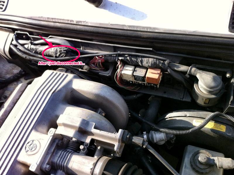

    I went out to check and sure enough on mine that wire is connected. I disconnected it and did about 7 hot starts and it seems to have fixed the issue. Here is a picture from that thread.
    Why isn't this a sticky? It is very easy to connect the two on accident if you are under the hood and see it is disconnected.

            so it was that elusive black gray stripe wire?
            • downforce22
              • Aug 2009
              • 3193
              exactly. It has only been 2 days but i have not had the issue anymore and in the pdf of the wiring diagram it is obvious that it should not be connected
