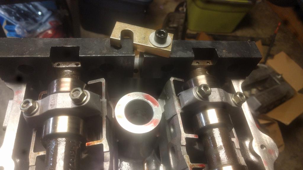

    Anyways, I cant lock the flywheel without a flywheel installed, but I'm having a hard effing time getting the camshaft on. I'm at TDC. I just cant get the camshaft alignment tool on and locked. Either the camshafts are in a bind or the tool is some cheap knockoff from China or both.
    Here's what I'm looking at.
    The camshaft braces and bolts are on but very loose to allow for some play. I cant seem to get the camshaft tool on properly to lock it in to place.
    Any tips?

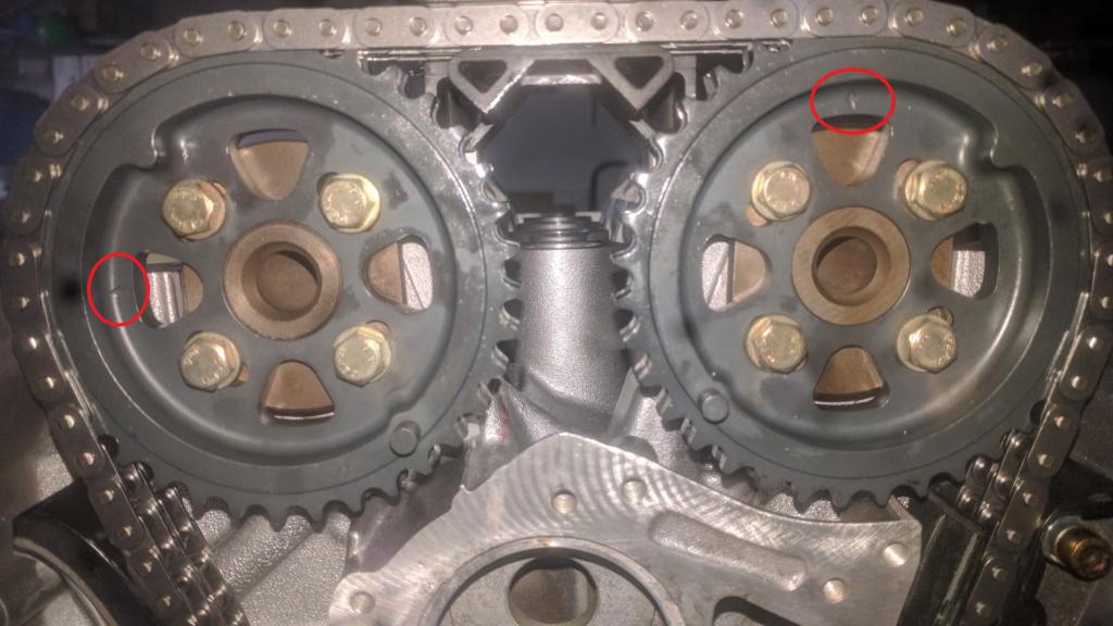

    Edit: To remove any mystery, I got the complete head, with camshafts from a machine shop.
    I think the camshaft has been disassembled. On the exhaust side camshaft, the 2 drilled holes at the end of the camshaft is misaligned with the arrow for the camshaft gear. I had thought the two drilled holes should be at the top for both camshafts, but having the arrows out of sync is throwing me off and will probably throw me off in the future when trying to set time.
    I'm setting the cams based on the drilled holes and ensuring those are level, but I'm not sure. Thoughts?

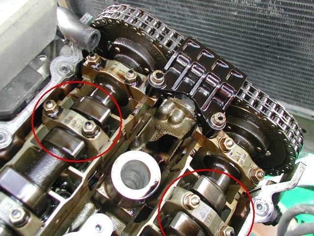

      Do you have the correct camshafts in the right place? One is marked with an "A" and one with an "E". The "E" is the intake camshaft, the "A" is the exhaust. The gears will only fit on the shafts as you have it or rotated 180 degrees. From your picture, the shafts are definitely installed wrong. Pull the shafts and get them lined up correctly before you bend a valve. To determine the correct camshaft position, use the camshaft lobes of the #1 cylinder. I forget which way they need to point but you can look that up.

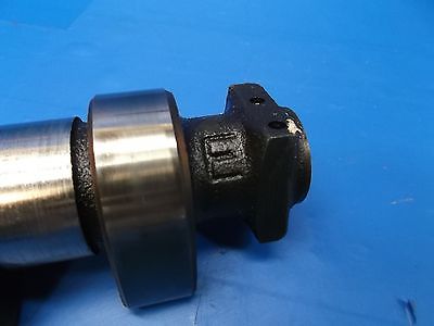

          This picture shows the lobes pointing to each other.
          This shows the "E" camshaft casting mark.
            The arrow on the exhaust cam gear will need to be pointing up like the intake one. I thinks the camshaft position sensor picks up on the pin.
              I see. I am fairly certain the cam shafts are in line with the lobes near the gears pointing to each other and matching up with everything I found online; but the sprocket/gear was not installed to the camshaft properly. If the camshaft position sensor reads that pin, it has to be fixed.
              edit: And I cant figure out the tool. It just wont fit, period. It probably was poorly made in China.
