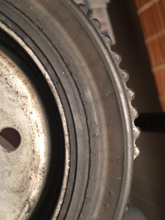

    The rubber ring on my M42 vibration damper has a hairline crack encircling the entire ring. Seems like this could cause problems when it warms (and if it flexes around the crank axis) but I'm just guessing. Anyone on here know what it takes for the rubber to fail enough to cause problems? I'm fishing for the source of the following problem:

    I don't see the crack in the photo...are you referring to the rough edge where the rubber meets the metal? If the damper was failing, I think you would know because it would probably make a hell of a lot of noise as it bangs around. Maybe try pulling by hand on the outside of the ring to see if it is coming apart? Whatever the case, I do not think that this is the cause of your problems.

      Good advice. Yes, I was referring to the rough edge where the rubber meets the outer metal. I heard no noises before or during the stalls, and the rubber feels sturdy when I yanked on the outer ring, so I'll move on for now.

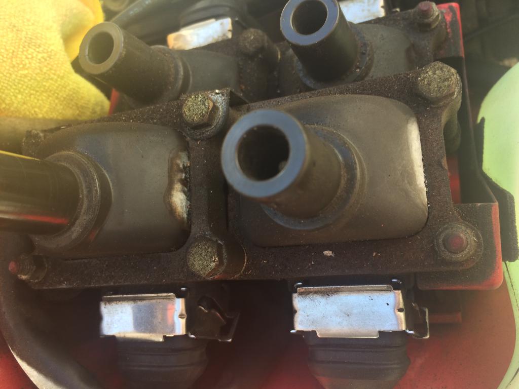

      The coils have been on the car at least as long as I've owned it (5 years), probably much longer. Took a look at them, plastic bodies on two have white blotches (see photo), the other two have moist blotches on the plastic too. They were all 0.7-0.8 ohms before running and after idling in the driveway. I'll have more time tomorrow to drive it around longer and remeasure, and pull off the bolts holding the coils to inspect them better. The m42 DME doesn't have a stomp code for bad ignition coils, right?

        Hmm, hard to tell if that is just dripped corrosion, or if the coils are crapping out. They would ohm out properly when cold if there was an internal break that only opened up when hot. Maybe try unbolting and cleaning them to see if the plastic bodies are damaged.
        It could also be that the plug wires are worn out and arcing through the insulation. That might also be thermally dependent behavior. But, at this point my money is on the coils since they do look sort of cooked.

                Well, I drove it around for several 30-40 min loops around the neighborhood and it ran pretty good actually. However, coils 1 and 2 were at 0.8-1.2 ohms after these loops, 3 and 4 were at 0.8 ohms. All dropped to 0.7-0.8 within a few minutes of the engine off. I was kinda hoping it would stall and I could ohm them immediately after.

                  I'd say that you should just find another local M42'er to swap coils with to see if it helps, but I am not sure how many other M42'ers there are on the island! So on the one hand, the coils do look sort of pooped, but on the other hand it is never good to start throwing money at a problem with unknown cause.
                  I think you should pull the coils, give them a good cleaning and take more photos if the bodies still look deformed or discolored. If so, then sure, go for the COP conversion (it is more than just bolting the thing on, you will need to trim the wire harness to do it properly...I think that the crimp terminals are just Amp Standard Power Timer ones).

                      Yeah, I need to find some other m42ers out here! Car ran great tonight for an hour straight, no stalls, power seemed pretty good. I unbolted the coils after and started cleaning them. I don't see any bulges in the plastic, just some baked crap on the plastic where the plastic meets the outer metal. Not sure what to make of this inconsistent issue. I'll try running it even harder tomorrow after work.
