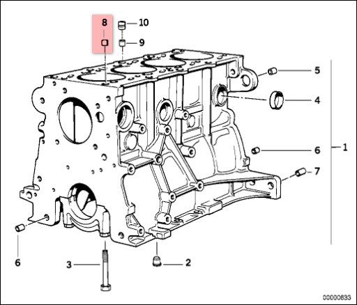

        For the deflection rail, i need to get those 2 bolts for it since there was not any that can transfer from the old lower timing case. Do you know if i can just order the same bolts that are used for the lower guide rail under the crank sprocket? Also i was looking at real oem for the part numbers and i wanted to confirm the part numbers to order, are these the right pieces?
        dowel pins : part number: 11121726241
        timing chain guide bolts: 07119919824 x 2
        • roguetoaster
          Biggus Tippus
          • 7830
          #109
          Can't confirm in either case, but I vaguely recall ending up with the wrong dowel pin initially when I had my engine apart all those years ago. Your best bet would be to measure the holes for the dowels as the part numbers correspond to different sizes, and do try to put dowels back in the same places they came out of.

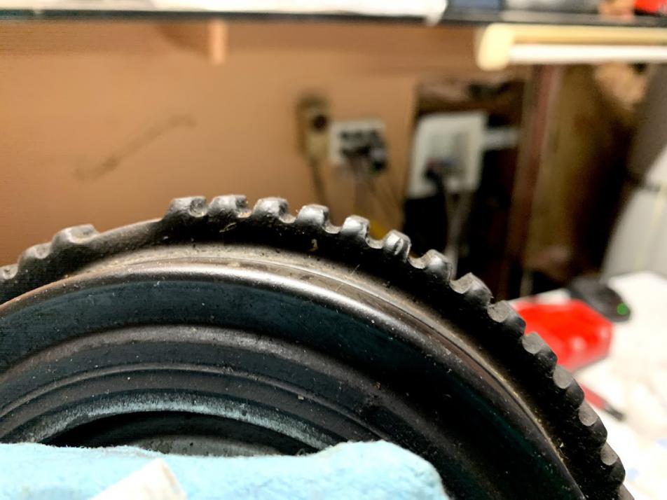

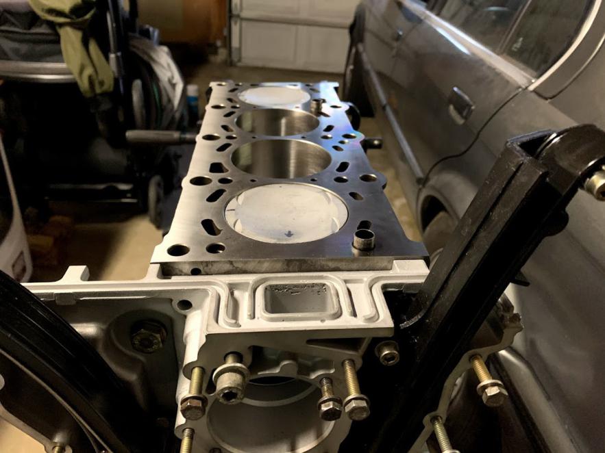

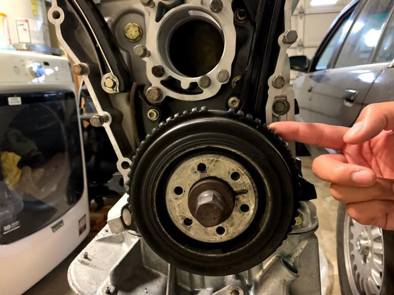

            i was able to take the ones off the hold head with some penetrant oil and they slid right off without damage. i've read in the back comments to crank it reverse 45 or to the point where none of the pistons sit at the top of the block before installing the head so there's no interference with the valves. i dont have any of the timing stuff on yet, but i am able to use my hand to crank enough for the pistons to lower. after i install the head, torque it down to spec, then install the cams at tdc, how do i get the crank back to tdc before i start putting all the sprokets and chain on? it's on an engine stand so i cant get the flywheel on it to use the locking pin tool.
            i put the crankshaft pulley on lining up the peg and hand cranked it until the most front cylinder's piston is all the way at the top. the crank pulley has a void that is facing up and 6 teeth to the right of it there is a line in the tooth and its where the oil filter housing is. is this top dead center?

              #111
              Should be pretty close to TDC. Why not install the oil filter housing and verify if you need accuracy for timing chain install?

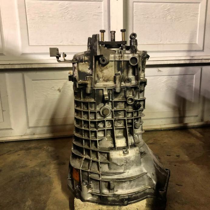

                              #119
                              everything is coming along, test fitted the parts again: a/c bracket, alternator bracket, engine arms, oil filter housing,etc all bolt up just fine. need to scrub and clean all the slude off it, maybe spray it with high temp paint to give it a uniform look with the rest of the engine. i already got started on the transmission and damn that was disgusting haha. i spray a bunch of zep degreaser and scrubbed with a brass brush. this after 1 saturday morning. still needs another round of cleaning, but i just want to get it clean enough to handle for reassembly.
Name:	UMNyx43uKLTO1KgOkz2XGtHJeFwYLOaJXx8JCXfImfiODoGAJJ-AYh714CXDckBBiv_6uiWZK74FEQ_f7oKpPRkey_T1mXVzB1SsiPfE1a0ij7PnMuBU1OX9mcVIGKiysaWGYho32bDxFv-OUpFkZfjKoEmj2F8V-cF_AeQWtIMr5pCHLhktwcG4OMtwPTfBGfHAR-iUqF_Ln8wP9P6gzzxI4O0iDFzPeef7mDwNQMVvlc7EXf56JSWQtcuBoQn
                              but i want to address the shifter before putting everything back since i dont want to re-access this area. i was looking at the short shift kit vs the shifter rebuild kit are these the same thing? the short shift kit is cheaper. i figure anything is better than what i got right now.
                              https://www.ecstuning.com/b-assemble...5117519669kt5/
                              https://www.ecstuning.com/b-genuine-...25117527252kt/
                              There are the 2 examples i am looking at on ecs. the short shifter buy sounds like knocking 2 birds with 1 stone, unless i am missing something?
                              • roguetoaster
                                Biggus Tippus
                                • 7830
                                #120
                                All you need is the rebuild/upgrade kit and just the short shift lever if you want a notchier shift feel. Link 1 has lots of important bits that link 2 does not.
