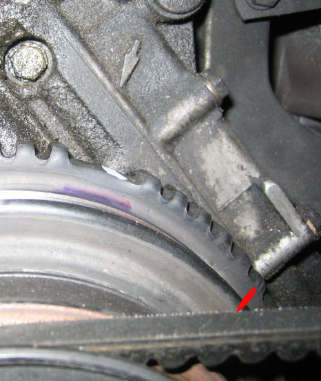

            There is a mark on the drivers side timing case cover that corresponds to a mark across all three [or four] ridges on the crank pulley. Line them up.
            The cams line up by placing a straight edge across the blocks all the way at the back of the cams so that there is no gap on the straight edge, best judgement is best, do not need to be perfect.
            Mark on case in green:
            Again with a red line over mark:

                Is this TDC?
                The yummy bits...
                What I managed to take out..waiting to the crankshaft locking tool to come in
                  No, there are three indentations on the pulley itself [in between the belts, if you will]
                  That and the cams on number one should both be point skyward when at tdc.

                      I buttoned everything back up, and well...it doesn't good AT ALL.
                      Strange thing is, it holds idle nice and steady, but there's a metallic noise, kinda like the camshaft lobes hitting the lifters really hard.
                      I aligned the cams to TDC with the tool, and I did my best to get TDC on the block.

                          Joe, check out the image below...notice the little red mark, I originally thought the large gap was TDC!
                          Oh and the noise was CRAZY detonation.
                          FIXED!
                          Took about 2.5hrs to tear down and put back together :)
                          Runs smoooooth :D
