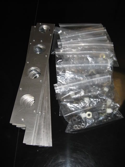

          We have a new batch of COP kits available.
          The kits include top grade hardware (no home improvement store stuff).
          $185 w/coils (shipped in the US)
          Coils are used but tested prior to shipping. One coil is modified to fit in Cylinder 1.
          $80 w/o coils (shipped in the US)

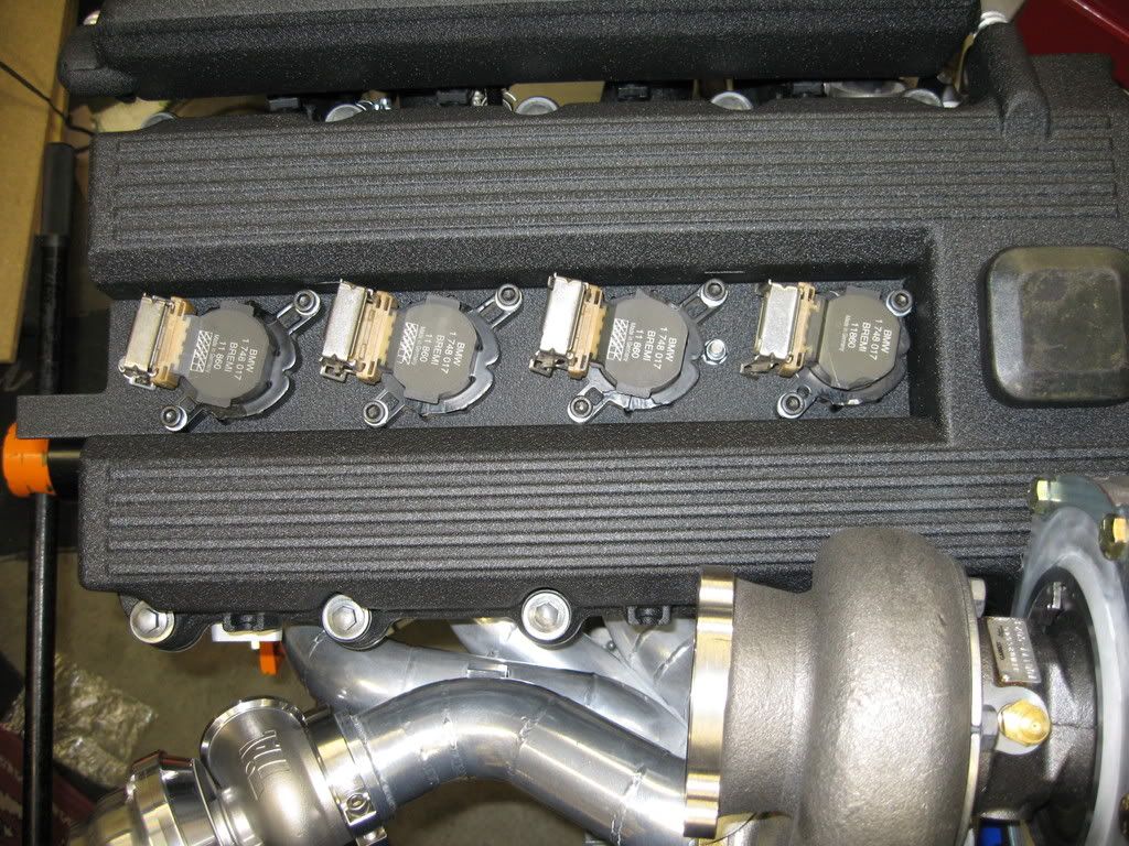

            What has to be modified to fit in cylinder 1? I'm thinking about ordering this kit and using either my own coils or coils off a later model 6. I can get them for free from a friend who owns an import salvage yard. It's nice to have a friend like that!
                This picture gives you an idea of the modification

                    I assume when you say Coil 1 is tested to fit in 1 that the other three need moification?
                      Coil 1 is the only coil that needs to be modified.

                        As for those asking what has to be done to the #1 coil - just look at the picture that was posted by e30pq - it's quite obvious... The #1 coil's top mounting point is shorter than all others. Other than that slight deviation, the coils are all plug-n-play into the cylinder head & onto the spark plugs. The swap or conversion is quite easy to do, just read the write ups online or the instructions included w/ any of the kits.

                              The bracket does get attached to the valve cover. The kit I got come with all the hardware, which consisted of threaded rods that screw into the valve cover, and then self-locking nuts, washers and spacers to hold the bracket on.
