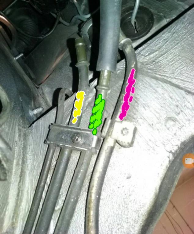

    Late model fuel lines
    I keep seeing different answers when I search. Which is feed, return, & charcoal cannister
  • bmwman91
    • Oct 2004
    • 3128
    Yellow = Return (pipe with more bends that connects to the left-most port on the fuel rail)
    Green = Feed (pipe which goes to the right-most port on the fuel rail)
    Pink = Charcoal can
