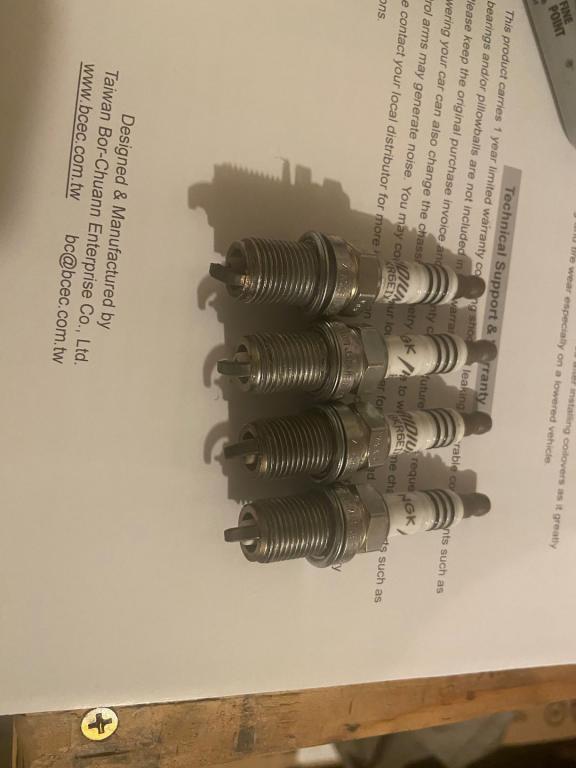

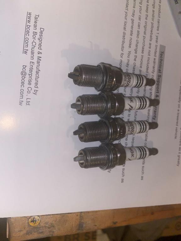

    Pics of the spark plugs are attached, not sure the cylinder order since I pulled these out a few days ago
    Let me know if you guys have any ideas!
    My Daily Driven 318is
  • roguetoaster
    Biggus Tippus
    • 7830
    Most likely it's a sensor with an intermittent fault, do basic checks on them, and read your CEL/look in to possible causes of that code. TPS certainly can do away with any throttle applied, probably won't come on during highway operation. While I doubt the plugs are contributing in any way to your issue(s), they're not the NGKs I'd suggest for a standard M42.
