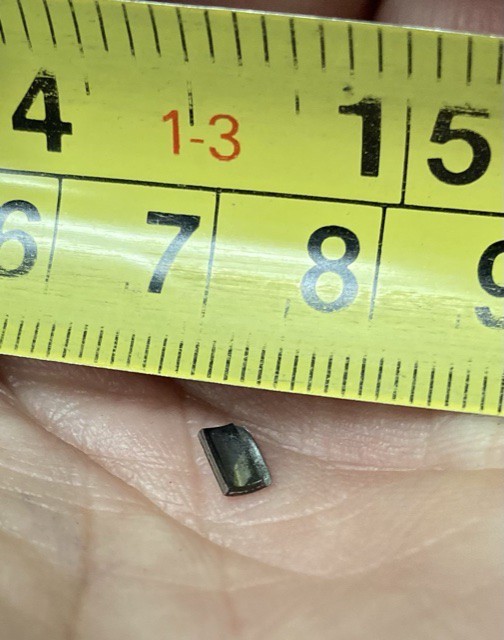

            I’ve been wondering about a metal piece found 5 years ago on my magnetic oil drain plug

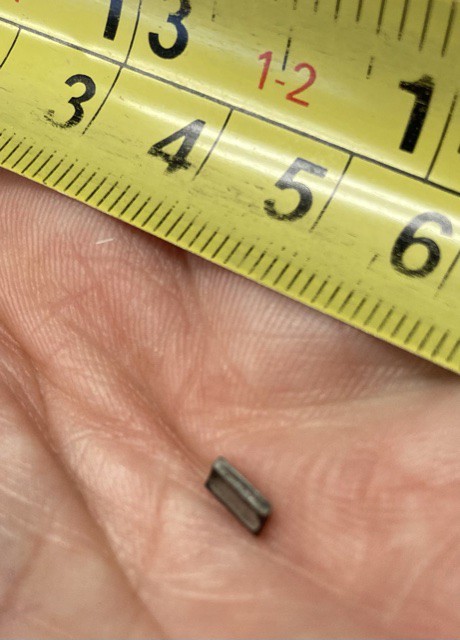

                A couple more pictures

                  That is definitely a piece of timing chain roller. Have you replaced the timing chain, tensioner and guides since you found the piece? If not, then you are due for a timing overhaul. Also, you really need to drop the lower oil pan and do some checking. It is entirely possible that other chunks got pulled up into the pickup and are sitting against the filter screen. As I and a number of others discovered, those metal bits can get pulled through the screen and explode the oil pump, leading to a total replacement of the timing case (assuming you don't cook the engine from loss of oil pressure first). The other thing you need to do is check that the bolts that hold the upper pan to the timing case are all still in place and tight. They have been known to work themselves loose and fall out, leading to one of the gaskets at the pickup imploding and running air into the lubrication system. They can only be checked with the lower pan off. If loose, spray out the threads on the bolts and holes with some brake cleaner and then reinstall them with some thread locker.
