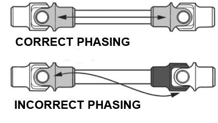

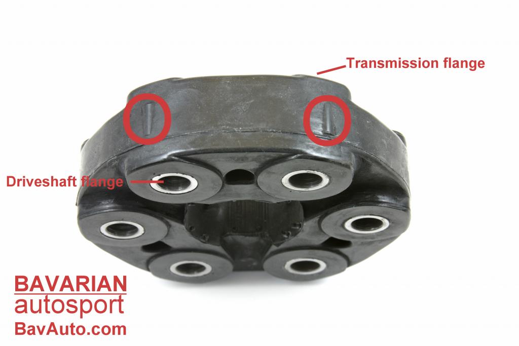

It was probably put together wrong. The universal joints need to line up (be in phase), and the giubo (flex disc) actually has a specific orientation. If your mechanic is not familiar with BMW, it's easy to do either of these wrong, both will cause a vibration. -
I'll ask them, do you by any chance know the specific orientation for the guibo? The vibration is between 35mph - 50mph.Comment
The drive shaft must have both universals in phase. Your drive shaft had to come apart to change the bearing. If the center splines are even off one tooth, the car will vibrate. Seeing it's between 35-50mph, I will tend to believe the shaft is off a couple splines.
There are arrows on the giubo which need to point to the flanges. Febi comes with a diagram/instructions written in many languages.Comment
