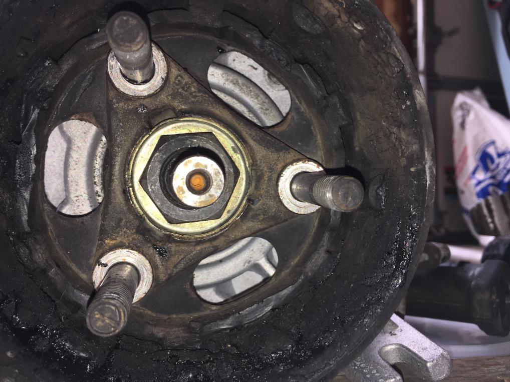

            I just bought this socket, thanks. Didn't seem to fit at all, but I forgot about the lock plate. It slips right on.

                  facepalm... Pried out the locking plate/washer, then I had enough clearance. I saw this mentioned on earlier reply but the photo was misleading, and mine didn't look like it would slip past the nut, but it did. Lesson learned. I would upload pics but there is a stupid size limit on photos and I'm not going to resize then.
