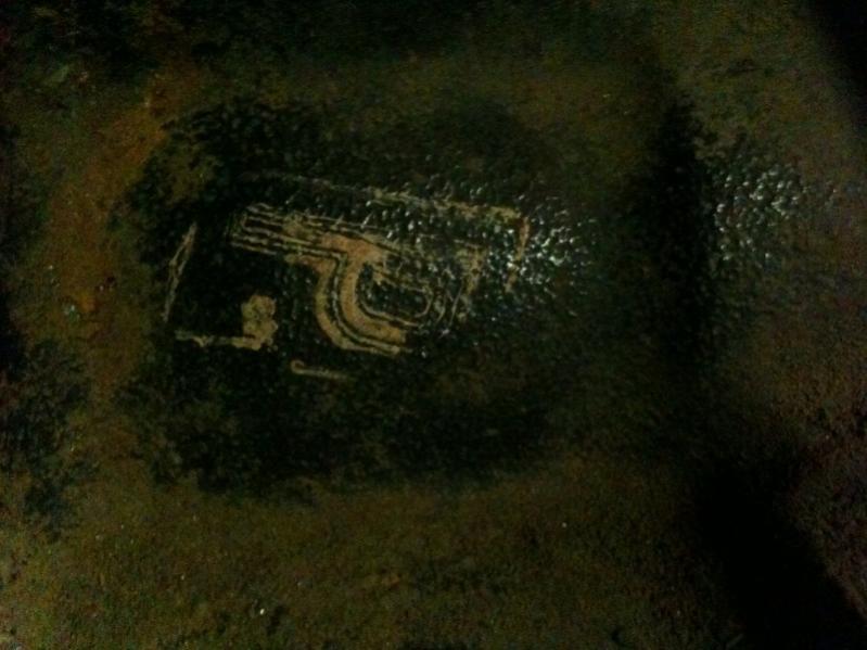

                Mine has a P stamped on the top in white.

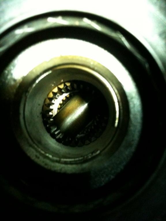

                  Here are pics:

                        One crossbar = non LSD

                          That's what I was afraid of. I thought I saw a pic of 2 crossbars but I couldn't find it. Thanks
