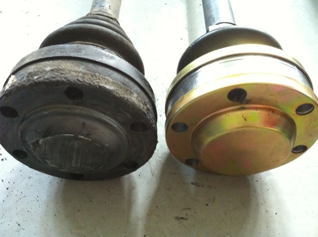

Drive axle "end cap" come off?
Tags: None -

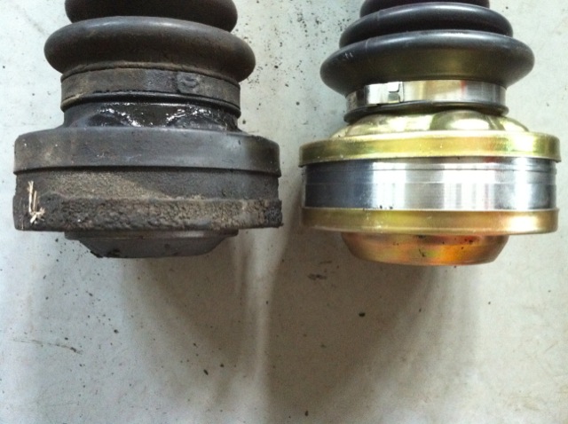

It looks to me like the caps aren't fully seated. You can tap them into place. Once installed the caps will be held in place by the drive flange and bolts/plates. So it is no big deal.The car makes it possible, but the driver makes it happen.
Jim Levie, Huntsville, AL -
Yea, but I'm talking about the "cone" area being too big and/or the right shape to allow the axle to seat into the rear diff flange and bolt up.Comment
