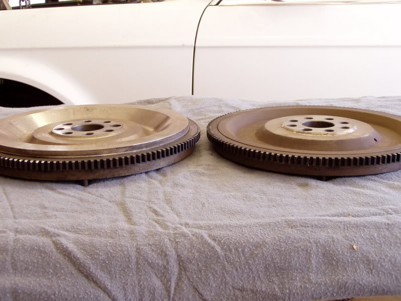

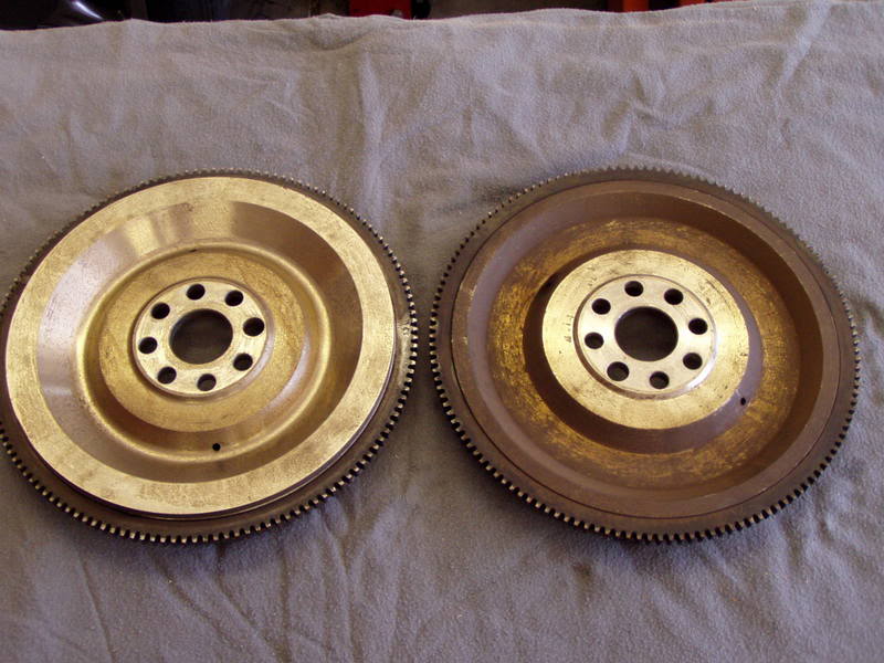

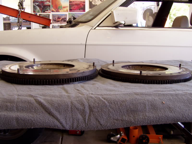

    Hey everyone I want to know if i should only be shaving the back lip on the flywheel... i saw pictures of a 323 flywheel which is what the flywheel should look like if it were shaved down...
    Does anyone have some photos to compare? I want to see where you shaved off the extra pounds to bring the m20 flywheel to around 12Lb.
    Any info would be great also.. i will be in the process of doing this, so please direct me.

    You basically shave off all the mass behind the wheel down even to the ring gear.

        My flywheel I turned
        • thebutcher37
          • 2877
          Nice.. im guessing thats how mine should look when i get 'er done..
          Here's some pics I found, Im not sure where from though... Thanks to whomever these belong too..
