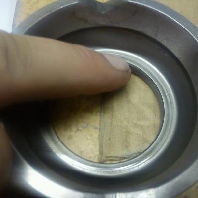

i'm in to change my lsd 25% diff to 40% or 75% i only use the car on track, it´s a race car. E36 318ti
my diff is a 168 mm, but i don't have this 4 mm spacer to take out for extra place for clutch disc, ant my top is the low one, i can get machine max 4 mm of it, but not 8 mm, then it will disappear.
I have machine my angel from 45 degrees to approx 30 degrees, but here is a problem more, then these 2 "kops" will go closer together, ant press on the 2 wheels that go in the spider gears. But i think i mite take 1,5 mm of them each. Is the picture with my finger on, the place i`m pointing at is where i will remove 1,5 mm.

Hey
I'm in to change my LSD 25% diff to 40% or 75% i only use the car on track, it´s a Race Car. E36 318TI
My Diff is a 168 mm, but i don't have this 4 mm spacer to take out for extra place for clutch disc, ant my top is the low one, i can get machine max 4 mm of it, but not 8 mm, then it will disappear.
i have machine my angel from 45 degrees to approx 30 degrees, but here is a problem more, then these 2 "kops" will go closer together, ant press on the 2 wheels that go in the spider gears. but i think i mite take 1,5 mm of them each. is the picture with my finger on, the place I`m pointing at is where i will remove 1,5 mm.
