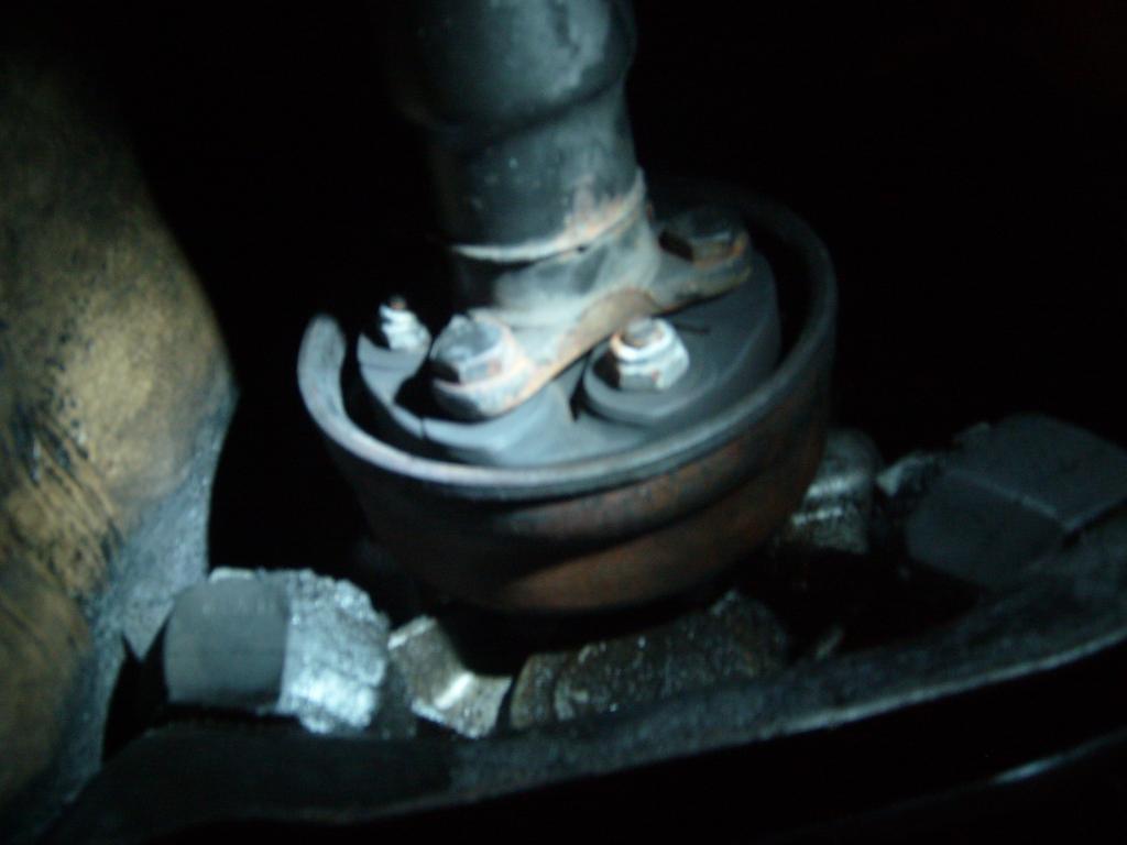

    So I have a balancer shield thing around my guibo. I loosened just the bolts that attach the driveshaft to the guibo. I never got anything behind the guibo to loosen the 3 nuts attached, cause at first I didnt think there were any back there since they couldnt be accessed. Then I got my finger to fit behind the balancer and felt the nut recessed in the back.
Name:	guibo shield.jpg
    I tried tightening it back up and they just kept turning. After driving 2 days a bolt popped out so now im trying to get it back in.
    Me and a friend got a nut back in using our fingers and make shift tools.lol but the nut is only on the bolt. theres still a lot of wiggle room

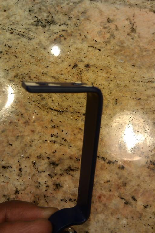

Name:	makeshift tool 1.jpg
    Imma try this thing i found in the basement tmrw to keep the nut from turning behind the guibo. hopefully it fits between the tranny. im soo out of ideas

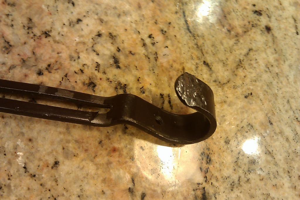

Name:	makeshift tool 2.jpg
    any suggestions??

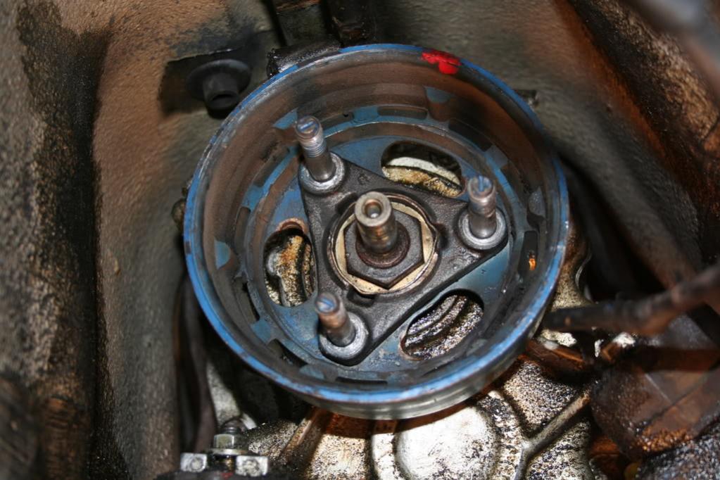

            Im only trying to tighten the one bolt attached to the driveshaft & guibo. It fell out. My 1st pic above shows how the driveshaft has the 3 flanges coming off it, which attaches it to the guibo. Then those nuts that u see in the 1st pic attach the guibo to the 3 tranny flanges.(pic below of the 3 tranny flanges)
            Even the bolt behind the shield are hard to get to. making removing the driveshaft (which i do not want to do) impossible anyway

Name:	guibo shield empty.jpg
              see..theres not enough room behind this shit to hold even these bolts down..this is the dumbest design on the car i think
              Thes ones in this pic (^) are already tight on my car actualy. its the bolts that hold the driveshaft to the guibo..the nuts are up against the tranny side and the bolt heads are facing the back side. the visible ones (bolt head) in the 1st post
