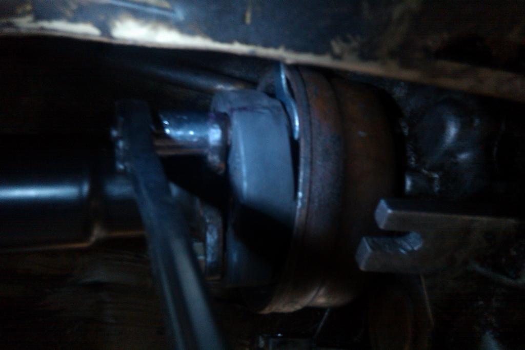

    Originally posted by tjmonsen5
    BTW, the studs on the trans should not spin because they are splined.
    If you have the newer style, you will need to fit a wrench back there and hold the head of the stud. Ive done it before, its not impossible.
    wait, wait
    so in my 1st pic..the nuts facing out are facing that way because those bolts WONT TURN IN THE BACK (tucked hidden behind guibo balancer) if i try to take the nuts off. I cant get anything to hold the bolt back there so if i go to turn the nut and the bolt spins im fucked with another bolt..andright now im having the worst time tightening just one.lol
    I tried loosening just the face of the driveshaft bolt and it fell out. I dont want to try and loosen that nut and the bolt behind spins, leaving me unable to access that bot behind th shield and stuck with 2. 'Cause then it will wiggle out like my drive shaft bolt did and ill be even more screwed.lol
    Thanks for the help tho..it sounds like u have actually had to work around a shield like this. If the bolt attached to the tranny flanges or whatever like my other pic wont move imma try it! let me know
    m20 is plenty. im simply a drifter.

      if it were that simple i woulda been done by now. holding anything back there to remove the driveshaft from the tranny is impossible for me. I cant keep the nuts in the back from rotating. again..they keep spinning inside the balancer!
      Anyone have a specific tool they used to hold down the nut in the backside of the balancer!? I need to get back to work soon and need my car.lol this sucks
      I dont even need to read anything, I saw YOUR posted PHOTO and already have the diagnosis.
      remove entire thing FROM the transmission with a 30mm thinwall as posted, scrap the old style balancer/studs and then re-install.
      if you have to cut the hardware off, SO BE IT. you need new hardware and to remove the balancer.

        I may have used a small adjustable wrench to hold the nuts on the back of the balancer. You shouldnt be having this much trouble. Or use a small vice grips to hold the nut while you thread the bolt into it.

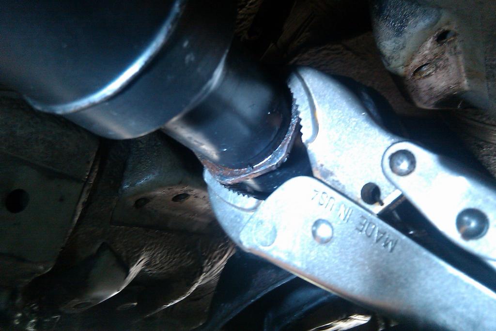

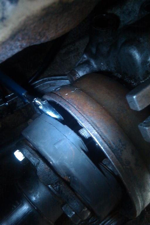

          anyway, to finally get to the nut holding the driveshaft to the guibo I had to lower my muffler all the way, lower the tranny as much as possible, unbolt CSB so the driveshaft could hang down and then unscrew the bolt behind that, compressing the driveshaft just a little bit, but enough for me to get to the back where the nuts were hidden away. This took me about 5hrs by myself.
          vice grips on the bolt behind the CSB baaarely fit so I would only get a tiny turn, then have to go back out from underneath the car and take it out of gear, then go back underneath the car and rotate the driveshaft to where the vice grips would lock on, then get back out from under the car, put it in gear, crawl back underneath and then get my 1/4 of rotation and start the process over & over & over.lol
          What ive learned after all this is I will NEVER touch the damn bolts that attach the driveshaft to the guibo Uness the guibo is already out. The driveshaft is a bitch to get out if the exhaust isnt completely out the way.

            I've just got done almost removing my driveshaft but just read this thread and the setup looks weird. Is this an early model setup? In my late model car setup and according to realoem diagram the torsional vibration absorber is in "front" of the guibo not the other way around like in the pic above. I can see how that setup would be real PITA to access the bolts behind the guibo!

                          I know this is an old thread, as I came across it doing some research, but based on your description and the pics you've posted, it appears that your vibration dampener is installed incorrectly. It should be on the drive shaft side of the assembly.
