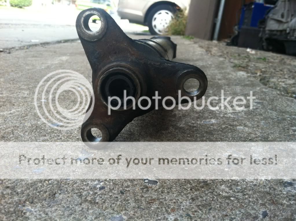

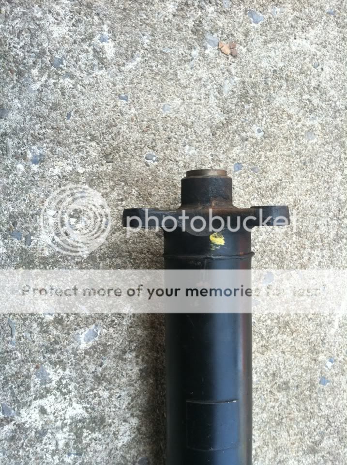

                Here is what I have.
                EG Hatch- ITR Powered, 4 door Gs-R-stock, 89' 325i
                • Mr. EG
                  • Oct 2011
                  • 270
                  To me it looks like the Getrag 260, which means I need what driveshaft? I am ordering a new one.
                  • reelizmpro
                    • 9558
                    Ignore the text in that picture. The Getrag 260 uses both a small and large flange like in the pics. Yours uses a big flange driveshaft. I've found late ETA's, M3's and apparently late 325iC's have the big flanges.
