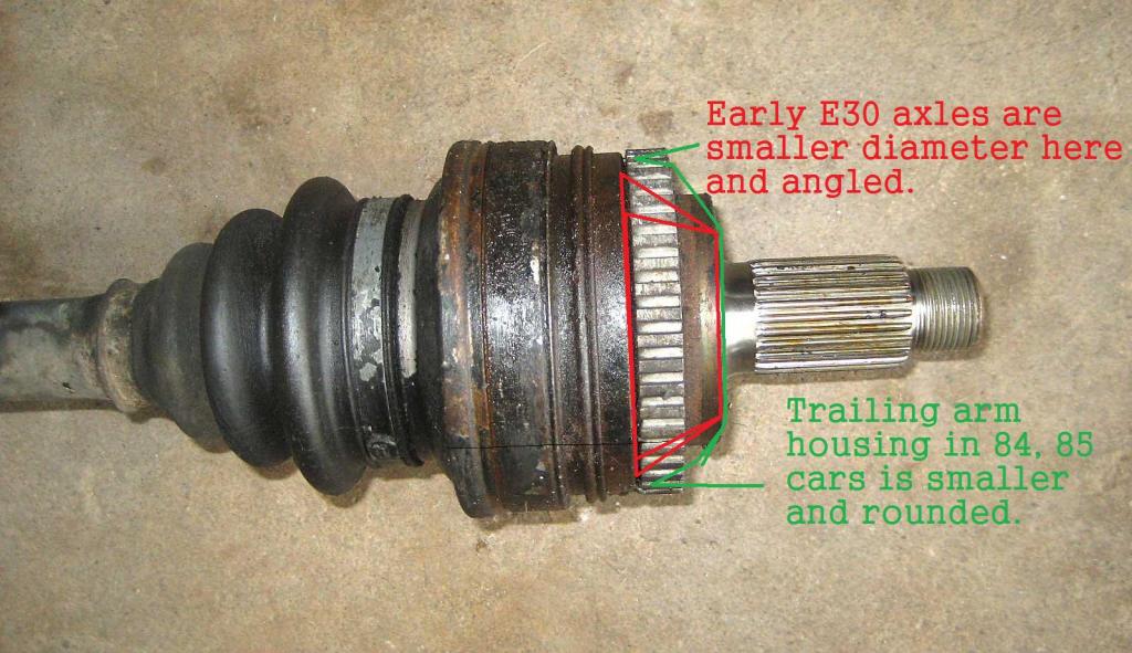

            Nope, there is no width difference between a small and medium diff. Yes I did buy the larger axles as that was my intent. Splines ARE the same but, and I do stress this, the housing in the trailing arm is different. So the large end on the larger axles (the big end where the ABS ring goes) is a larger diameter and a completely different shape. Basically The late axles are too large and not rounded off like the early axles so when you tighten it down it presses inside the trailing arm housing itself. This is when I found out those trailing arms I got for that disc brake conversion were off an 85 as well. FFFFUUUUUUU!
            Originally posted by DEV0 E30
            • Holland
              • Nov 2008
              • 7212
              Here is my example, and removing the ABS ring does not help, it's a square peg in a round hole kind of deal. This is a late axle.

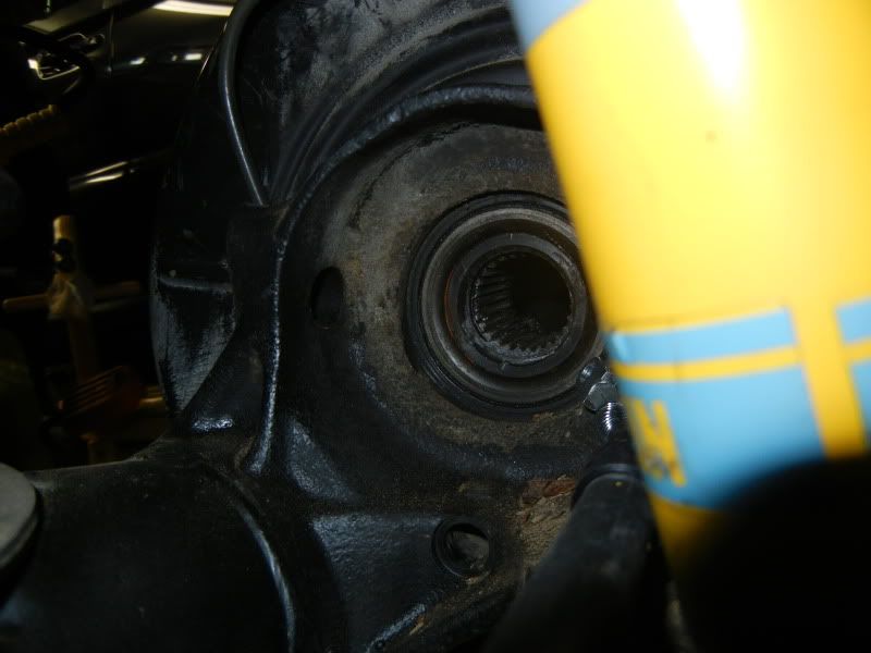

                  Here, I took a pic of the back of my hub - I can clealy see the hole where an ABS sensor would go, and the bore is definitely more squared than my 318i stock hubs (which were drums, of course).
                  So since the late 318s also had the small-case diff, but had ABS hubs on the outer, that should mean that with my current setup (small diff, 325 hubs), a late 318i axle should be a direct fit, correct?
