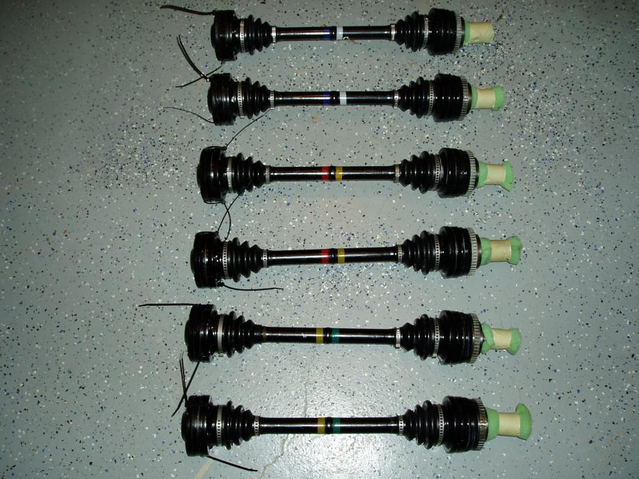

                          I sent my front iX shafts out to a rebuilder on the east coast. 160 Each with a lifetime warranty. CNC rebuild with oversize bearings. Quality and you get your factory shafts back. Shipping is extra, there and back

                              There are several parts that can wear or crack in old shafts, changing the boots and adding new grease is a very small part of a rebuild.The cages wear which causes the bearings to lock up, the star also wears which causes the housing to lockup. I buy all these parts new and they are OE parts. The boots & clamps are also designed for these half Shafts that I use with no shock absorber hitting.. I installed a set on my car 260,000 miles ago and there still running great. About splines, they usually do not go bad, unless your bearings go bad or your hub nut and lock washer are faulty.. Also if you use a hammer etc for disasembly you can damage your splines very easily. The best shafts for your car are OE they are much stronger and way better quality, but then again you get what you pay for. I sell most of my shafts to Europeans and they pay close to $600.00 a set and love them.
