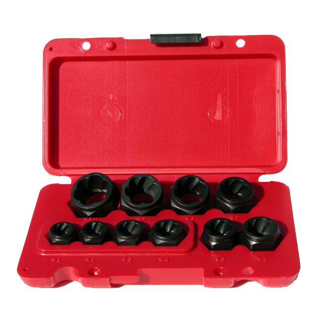

          I had one strip once and used this http://www.harborfreight.com/9-piece...ets-67894.html with excellent results!!

            Once the engine was out of the car "that damn top transmission bolt" was out in 30 seconds of trying thanks to the Craftsman damaged bolt removal kit.
            I had never used those suckers before but they are AWESOME!
