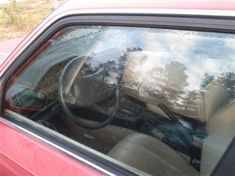

              It is an airbag car judging from this pic. However, I still don't know where to disconnect the damn brake pedal from the booster. All I see is 4 nuts on the firewall.
              Just for peace of mind, this IS the SRS wheel, correct?

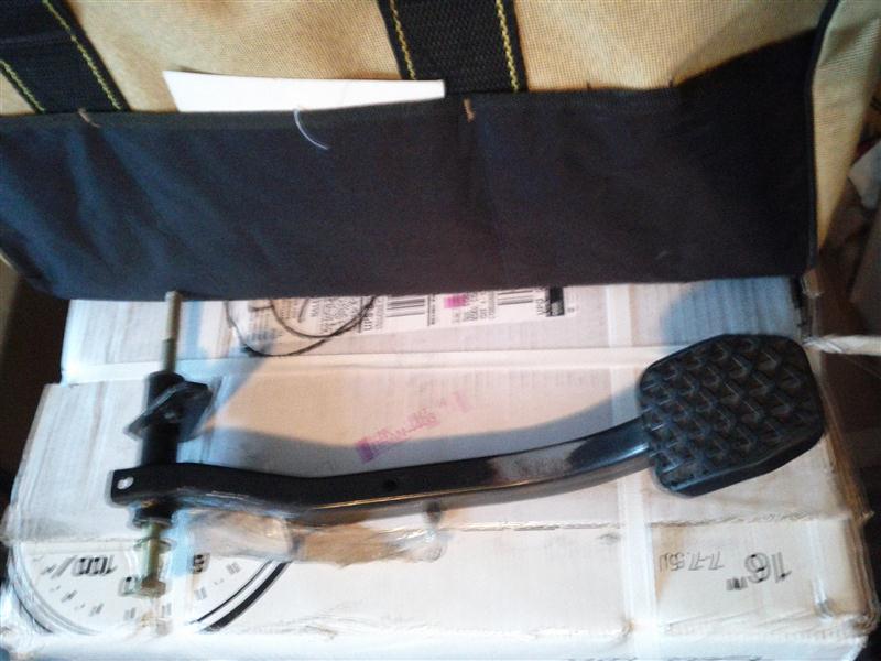

                  So I picked up the GD brake pedal today. Pushed the pin out, pulled it off.
                  I attempted to get the pedal box out... yeah NO. The damn column had those bolts with no heads on them... I believe you refer to them as shear bolts.
                  No way to get them off to drop the column to get the pedal box. Looks like I'll be sourcing a pedalbox if the SRS car doesn't have the same one Auto to Manual.
                  Can anyone confirm?
