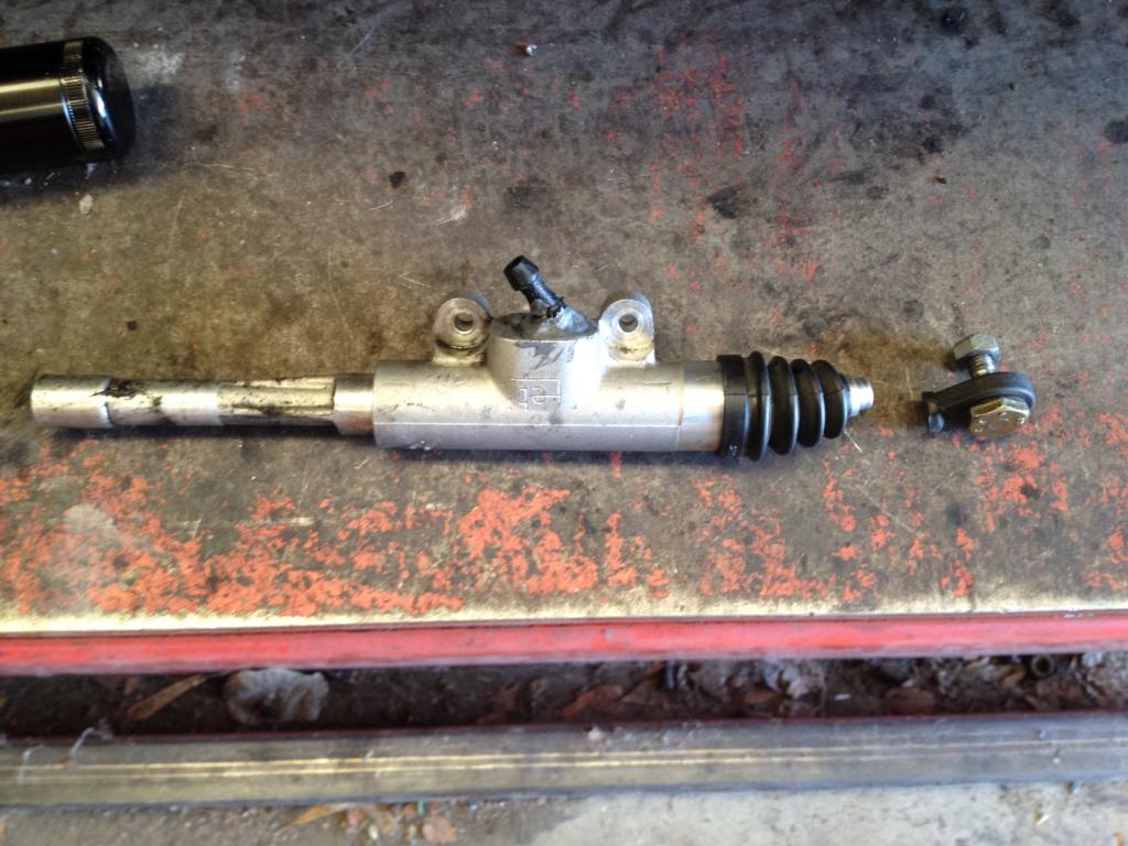

                    Okay gents. I looked further and found quite a few things. First off, the clutch master cylinder had snapped at the eye-joint where it attaches to the clutch pedal (as reelizmpro said) So I purchased and installed a new one.

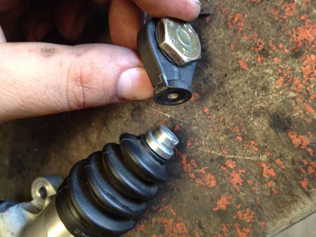

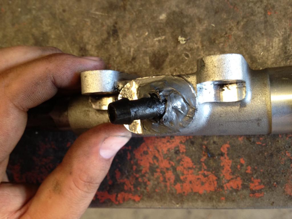

                        I took a moment to stop and think before taking on the task of dropping the tranny, and I think I may have posted my last post too soon.
                        I bled the clutch more and realized that it needed it really badly. After doing that I turned on the car and was able to put the car in gear with the clutch pedal depressed, showing that the slave cylinder was, in fact, doing it's job and pushing the fork away.
                        Everything is gravy now. BUT!
                        I still don't know why the clutch got more difficult to press in the first place. What caused the clutch pedal to be so hard to press that I literally snapped the clutch master cylinder? All I replaced was the master and slave clutch cylinders. The master was butchered pretty badly. Could this have been the source of the increased pressure?
                        As of right now I am back on the road and it is driving better than ever. But I am still very leery.
                        Anyway, here are some photos of the broken parts.
