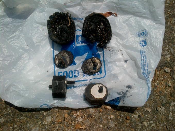

              dohcdoh is going to get on my case again but my load/unload driveline clunk was caused & fixed by whats in the pic
              If you have to ask what they, buy a Kia now !!

                I have solid engine mounts and E21 tranny mounts with cups. Brand new from last year.
