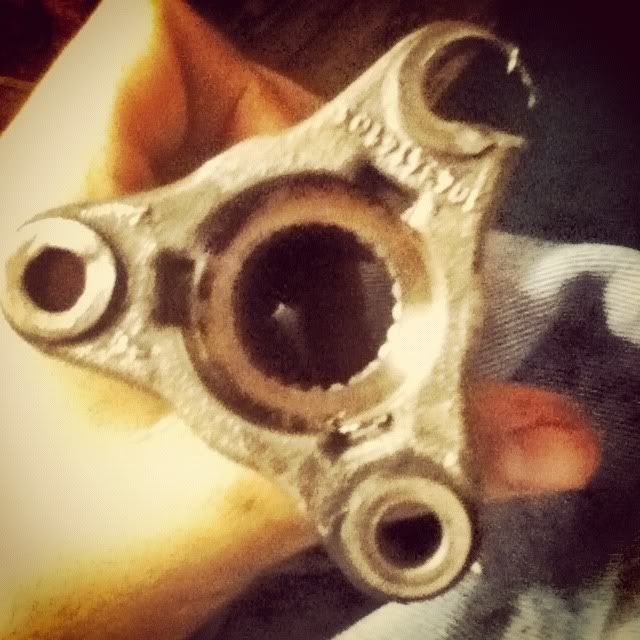

    Where do i get this Output flange
    I have a 25 spline, broke ass output flange and no idea where i can get a new one. I've been surching for the past 2 days and have has no luck, Its for a 2 dr, 1990 325i, But im not sure if its the stock trans. Heres a pic....

    manual or auto? there will be a difference

      It's an automatic

        do you know the trans number? 4hp22? looks like one. if so you should be able to get one from alot of cars between 86-94 including 535s, 530s, 318s, 635s, most m40s, m20s m30s ran those trans. the output shld be the same

          time to have fun in the junkyard. likely be the fastest way to get one, albeit a bit of a pain in the ass to get off.....

            4HP22's sell for 10c/lb. Easier to find one than to figure out what do to with the rest of it after you pull the flange but someone HAS to have a blown or swapped one laying around that you can steal the flange off of for a case of beer.
