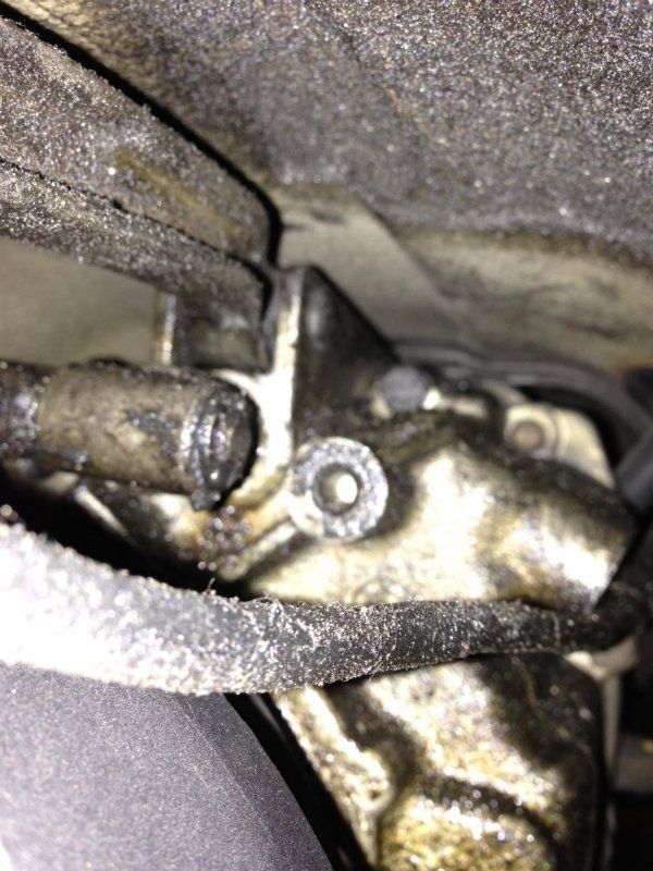

Shifter has been hard to shift into reverse, and sometimes will not engage. Today it took a few more tries than usual, but got into reverse and backed out of the driveway. When I went to shift into first, the lever went into what looked like neutral, but when i let out the clutch I was still in reverse.
Searched on the forums and checked under the car. Managed to stick my phone above the tranny and take some pics.
Comparing the picture to this diagram:http://realoem.com/bmw/showparts.do?...68&hg=25&fg=05
it looks like #2 (bearing sleeve) worn down enough so the #1 shifting arm slipped off?
