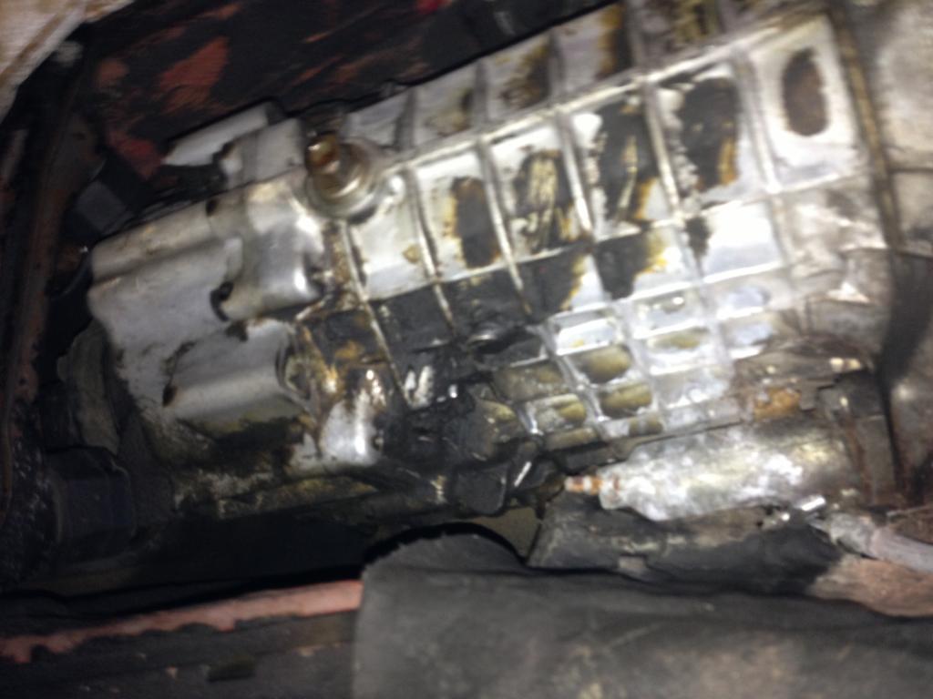

                    If you have a female 17mm hex drain and fill bolt and you cant find any labels, then use 70w80 GL-4 (it is critical that you use GL-4 and not GL-5).

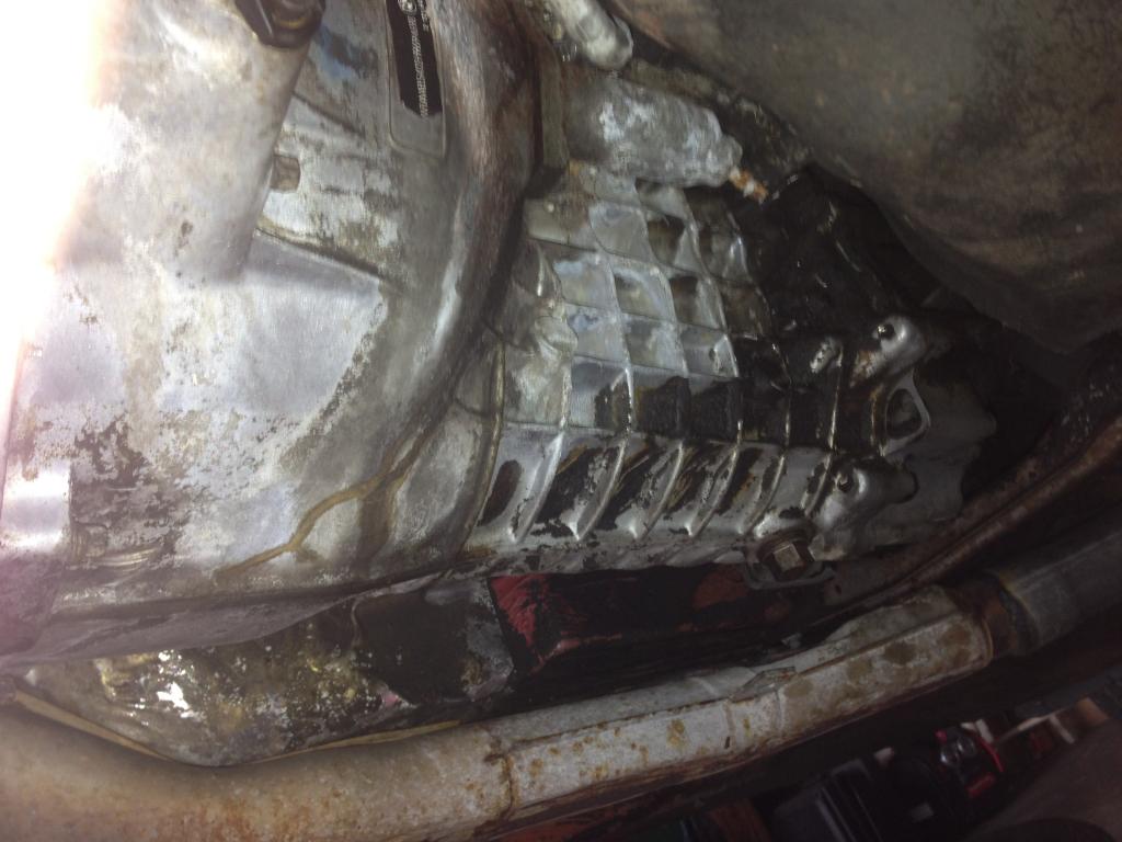

                      Mine has the male 17 mm bolts but no label
                      • amcink
                        • 788
                        Mine tramission
