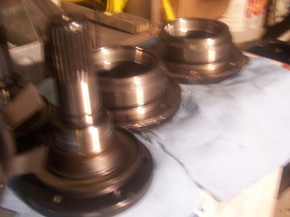

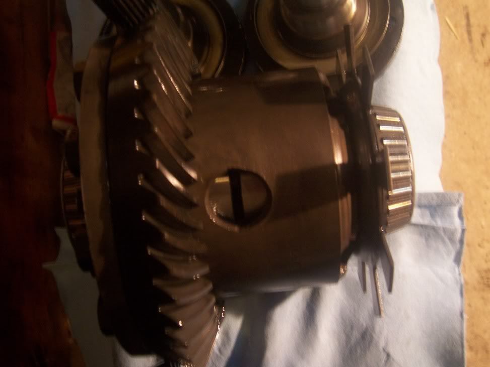

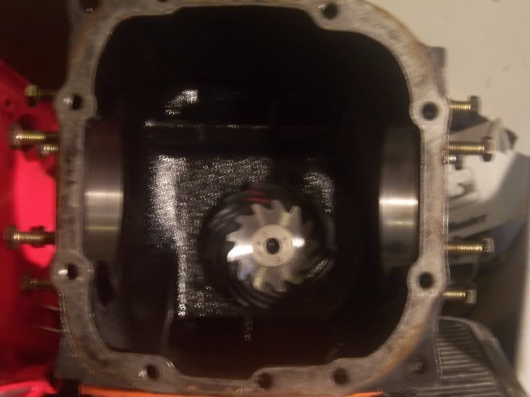

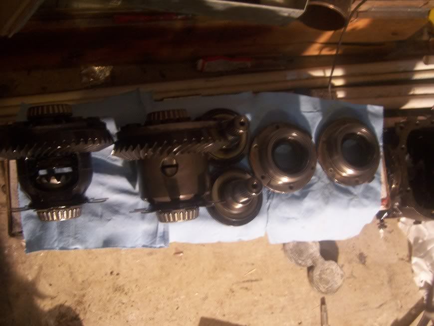

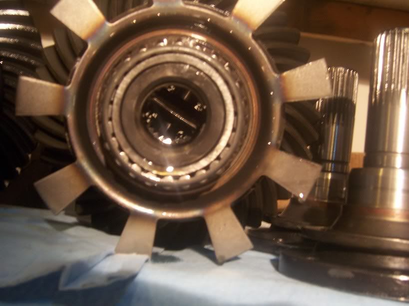

            here are some updated pics. It ended up being a 3.46 which is better than a 3.25 that I originaly though it was. I took both of them apart (very easy), and now I'm just waiting to use airtools tomorow to get the ring gears switched.
