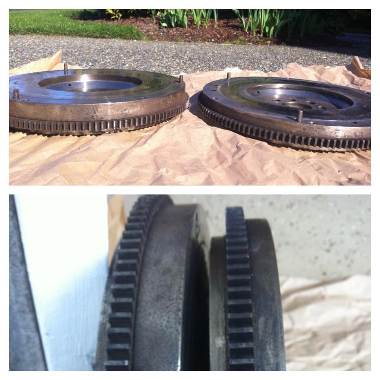

Here's a couple pics of an 325e fat single mass and a 325i single mass. The e came out of a 02/86 car with a deep bell housing on the transmission.
The 325e is 38 mm thick and the 325i is only 33mm. 325e's also came dual mass.
