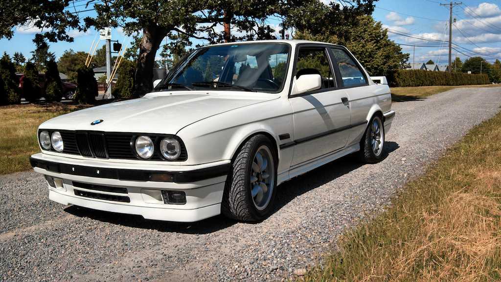

    Firstly i am new to the forum here, so hello all.
    I just bought a 1991 318iS and would like to help it spin up a little faster by installing the 325i single mass Flywheel/Clutch/Pressure Plate. Unfortunately i do not have the mechanical gene necessary to accomplish the job and was wondering what it would cost to have the job done by someone who has the experience.
    I live in Brooklyn, NY. so would like someone close by who could source the parts and install them.
    Your help is appreciated
    Here's my new car.
