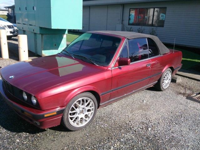

            It was me! inexperience and rushing...
            I overlooked that the cross member is not symmetrical, and I had lined up the linkage guide into wrong hole. Once I pulled my head out, it all lined up, bolted on and seems to be working well.
            Thanks for all the replies.
            It's dirty because it won't stop raining..
