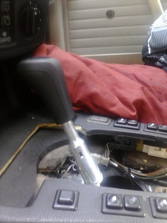

          i did look at it, but i cant quite tell. it kinda looks like he put the wrong linkage and the shifter backwards :/ il try 2 post pics in a minute

            Here's what it looks like in first gear.

              and before you ask, yes i drive it like this XP
              Keep it sideways!!! XD

                Lmao po is a tool bag.
                Looks like shift carrier is wrong, should be centered.
                  Wtf...so instead of fixing the issue he damaged the center console, leaving you with more of a mess to clean up.
                  That sucks man. Even with the shift carrier being wrong, just rotating the actual lever around (which is backwards btw) would have made it a lot better.

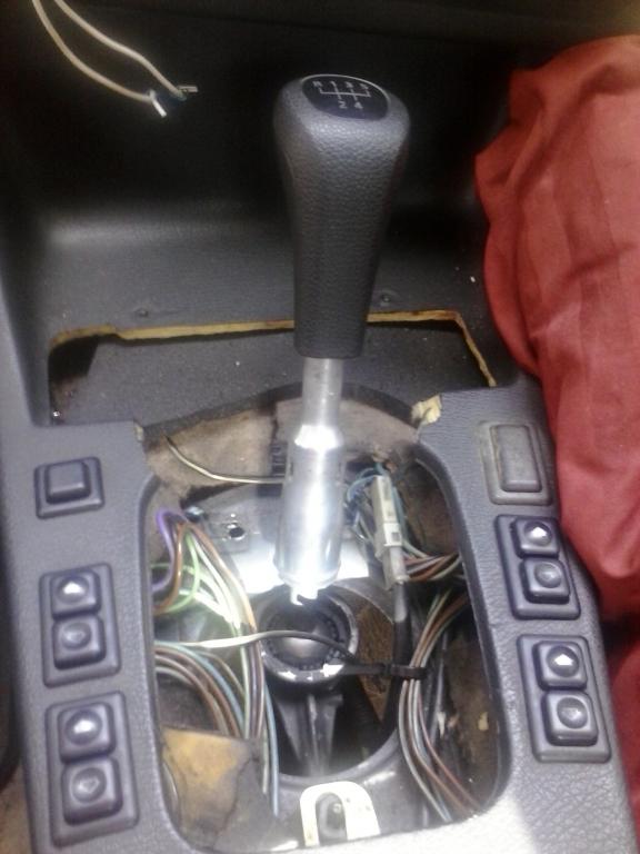

                    ya lol, that guy was a tool. took the radio out b4 i bought the car too. im gonna go twist it around lol. what parts do u think i need?

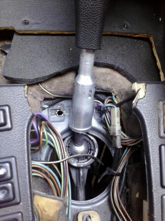

                      Well here's how it sits now after twisting it around the right way. The pic is it in neutral. Any suggestions on how 2 get it centered now? :/

                      • FLG
                        • Sep 2011
                        • 3165
                        Get the correct shift carrier. What model is this? I might have another spare
                        Nvm saw first post will check tonight

                            Could have the PO have put in the shift carrier from a G240? Are the shift carriers from G240 and G260 different?

                              • AndrewBird
                                The Mad Scientist
                                • 11898
                                RealOEM lists two different part numbers for G240 and G260 shift consoles. Not sure what the difference is though. I would just start by getting a new shift console, new selector rod and all new bushings. Start from scratch and make it right.
