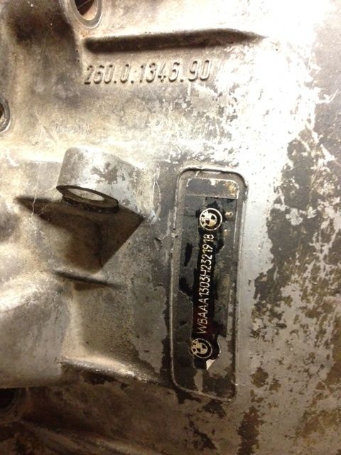

              Pulled from a 1989 325 coupe. Small guibo, only provision for late shift carrier.
              Level on bellhousing face, black sharpie line where it exits the slave hole.
              Measured.

                Haha. Nope. But now that we have pictures of both, there is concrete proof that there is a 1/4 inch difference between the eta transmissions with a late style shift carrier, and an i transmission.
                Shoot me a pm to claim your prize!
                I would still love this thread to have a picture of the depth of an early eta with the stamped shift carrier provisions, to see if there is a split between early and late eta transmissions with the same part numbers.
