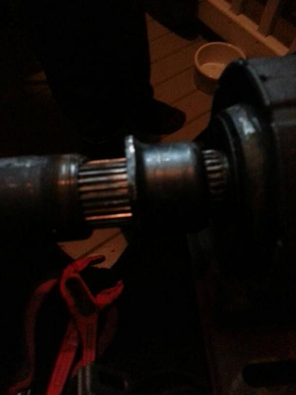

                thanks guys, I ended up angle grinding most of it and hitting it with a chisel. (heat didnt work either so I sakd screw it) Click image for larger version
ID:	7165387. Now how do I get this off? picture is trying to show both halves off and the driveshaft lock on it. do I use a puller for it? I was on pelican parts to no extent and searching the forums for a diy, but did not find one besides pulling the bearing off with a puller.
