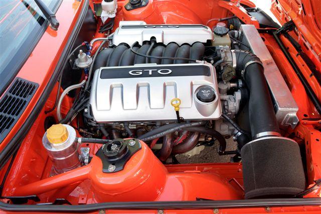

        Do you have any ideas of where to get the wiring. I saw someone with the gauge cluster I could do I will have to find the thread though really quick.
        Want to help if this all goes through like I plan?
        Something like the pic? I couldn't find the cluster pic that a member did to his that I liked

          I am doing the same swap... here is a list of problem spots I wish I knew of before.
          1. Oil pan will not fit but an aluminum 7 quart oil pan can be fabricated easily w/ new pickup
          2. The driver side manifold will not clear steering even if converted to manual, so again a custom one must be made.
          3. I made custom mounting points on the front frame itself.
          4. The electric fan must be used in front of radiator (pusher)
          5. Tranny mount is stupid easy to make since there is a slider bolt system.
          6. Painless makes a wiring harness and fuse system so it is easy to wire up.
          7. A rebuilt E30 LSD will hold the power just fine but I suggest nothing higher than 3.25.

              with a 3.73 the first gear is completely useless... No I have no pics of it as of yet.
              Autometer makes gauges that work perfect all you have to do is wire them up.
              I had the exhaust manifold, oilpan, and mounts made by a local guru named Jeff Hallowell... He makes the best tube frame dragster chassis I have ever seen.
              with my mounts I had almost three inches of clearance on the hood..
              with good coilovers and a bigger sway bar the handling feels better than stock
              O and the biggest one Is you either have to switch to manual brakes or fit the 540i's remote brake booster system (which I did)
