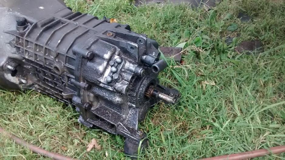

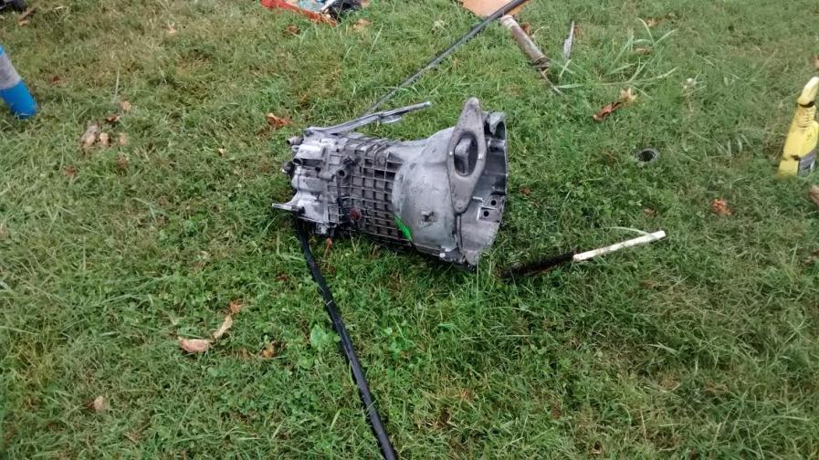

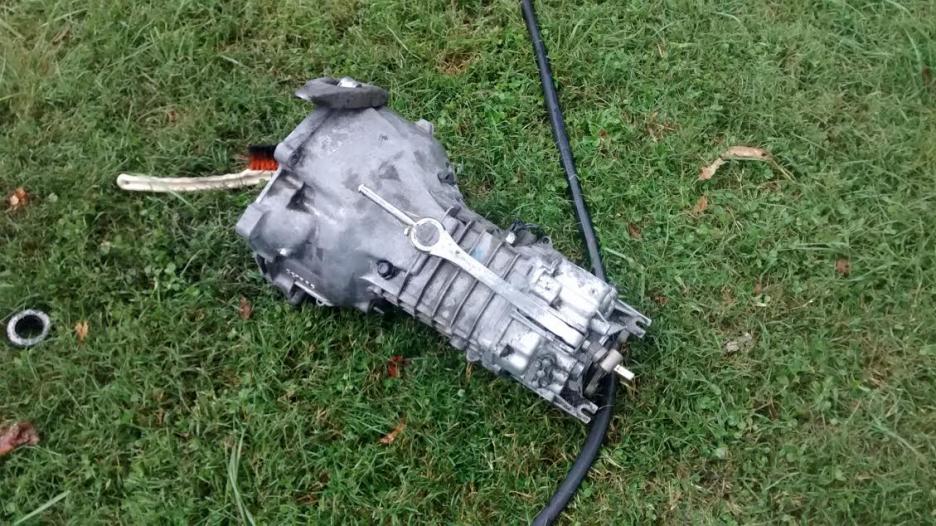

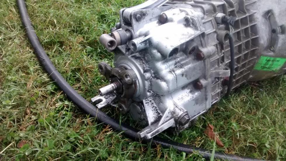

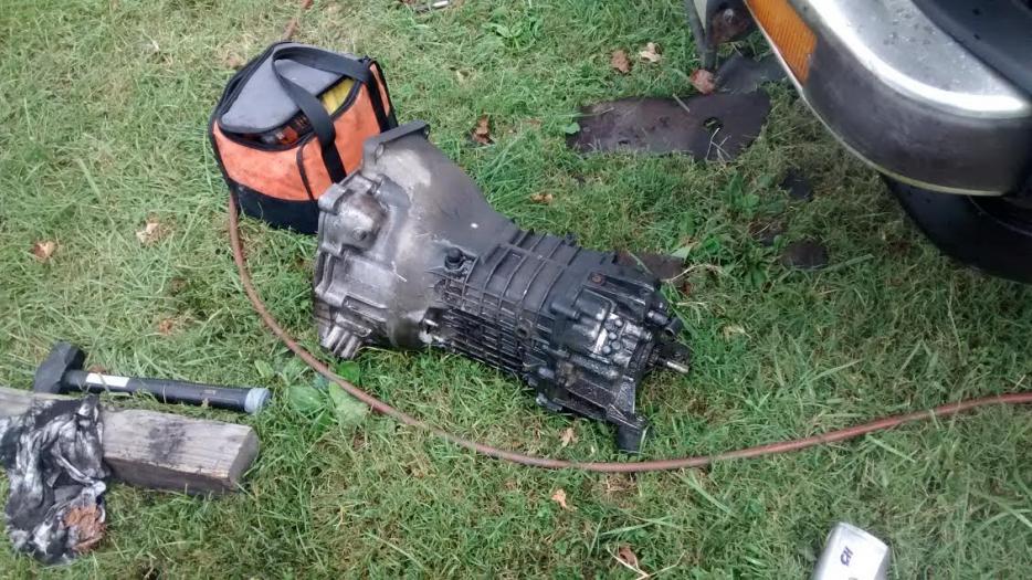

Ok so I have took everything I needed off the old tranny and put it on the new tranny (shifter mounting bracket, big 3 driveshaft output shaft) and I was like "ok let's throw this in there." Then I thought to my self "I will regret it if I don't give this thing a decent cleaning" because it has a new slave and new sensors, and I also replaced the clutch fork bearing. So I thought what a shame to put new parts on a dirty tranny. I thought I would just rinse it off, but NO my butt had to get the tuff stuff and scrub it lol. I have found in the past though that a clean part will tell you where the break is or leak if it's clean, so all in all this should be done anyways. The pics are of the new tranny cleaned up (it was dirtier than the one I took out) and shows that the output shaft splines are the same. I put in new seals too :) just had to do it, they're just 4 bucks. And I put a pic in of what cleaner I use, you can get it from wally world ( I am in no way endorsing or getting paid for using it) I have oven cleaner and all that jazz but it can sometimes die aluminum white so I like this one, it foams great when you start scrubbing.
In With The New, Tranny That IS:)
