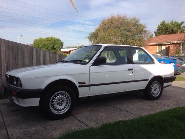

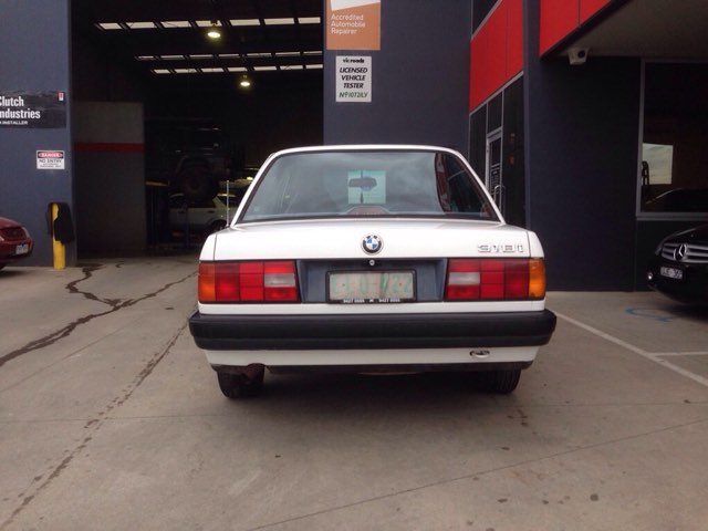

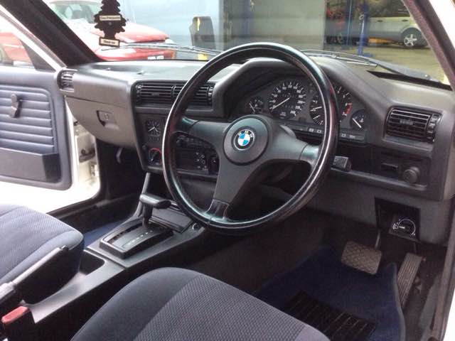

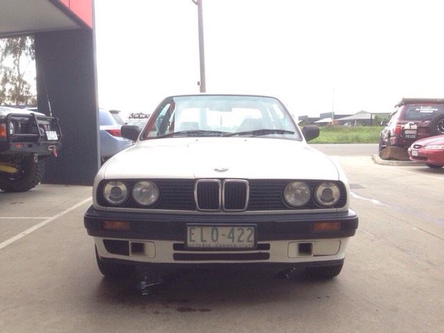

    Hi,
    First post here. Quick background on the current project, I have a 1991 M40 Auto coupe which I've purchased for next to nothing which I'm planning to convert to an M20B25/G260. I have also picked up a 1990 5 speed 525i as the donor.

    My question is: Which Shift Carrier will I need? I'm pretty sure it's the aluminium type not the flat steel plate type carrier. If anyone could clarify that would be very helpful.
