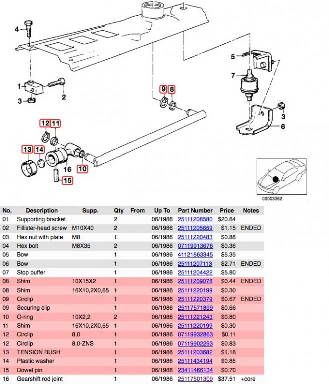

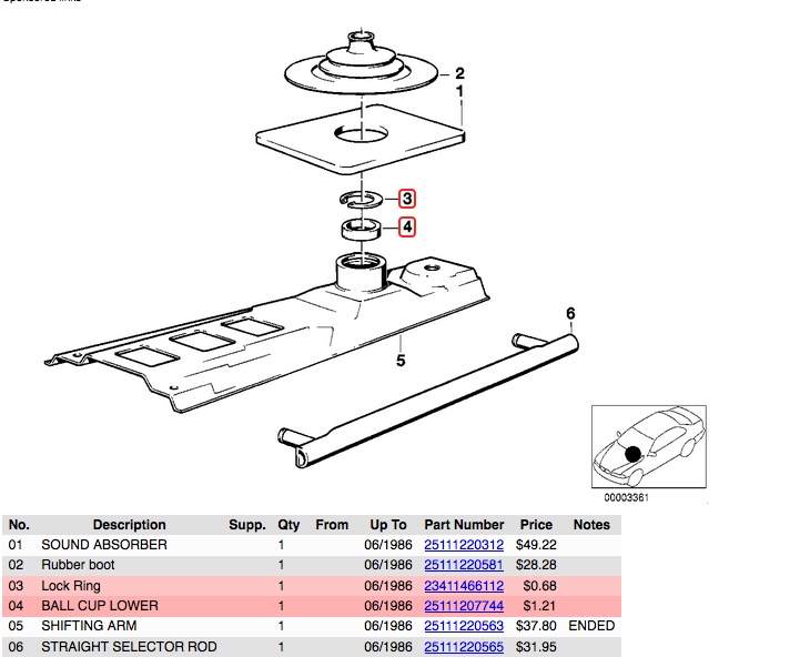

    Transmission is from an '86 325e (Produced 09/'85).
    Is it worth replacing shifter parts/bushings? Or should I be looking at swapping to a new-style carrier?
    Here are the parts I was thinking of replacing.
    In addition, I should really be replacing the two Supporting brackets, as the rubber bushings inside the ones I have are very sloppy. These are $20.64 EACH.
    Shifter parts needed:
    23411466112 - Lock Ring - $0.68
    25111207744 - Ball Cup Lower - $1.21
    25111204422 - Stop buffer - $5.80
    25111220199 - Shim - $0.30 (Old PN: 25111209078 )
    25117571899 - Securing clip - $0.66 (Old PN: 25111220379)
    25111221243 - O-ring - $0.80
    07119902293 - Circlip - $0.83 (Old PN: 07119932863)
    25111203682 - TENSION BUSH - $1.18
    25111434194 - Plastic washer - $0.85
    23411466134 - Dowel pin - $0.70
    25111220228 - Cap - $3.31
    07119932881 - Circlip - $0.38
    23411666133 - Rubber Ring - $1.77
    25111220221 - Washer - $4.39
    23411666122 - Spring washer - $1.75
    23411200844 - Spacer sleeve - $2.27
    23411200845 - Compression spring - $1.33
    23411466110 - BALL CUP UPPER - $8.01
    TOTAL: $37.20 + ~$40

    Just looking at prices on RealOEM, it looks cheaper to just get new parts for my plate-style carrier.
    My Getrag 260 has provisions for both though. If I can get some parts used it might be worth the swap?
    Is the newer style shift arm any better in shifting feel/performance?
