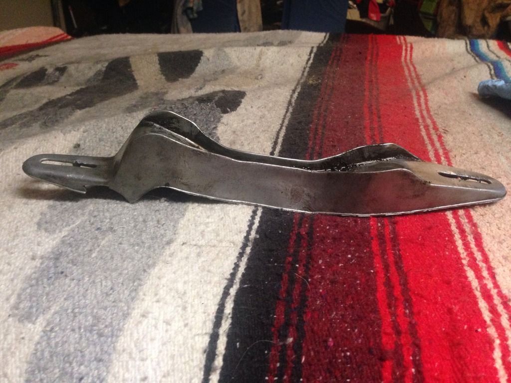

    Right away I noticed the aluminum transmission cross brace/support had a big piece missing. You'll notice it right under the slot for the bolt on the left side of the picture.

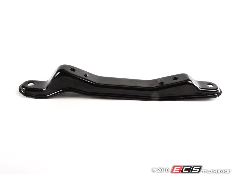

    Ordered a replacement, and the one that arrived looked a lot different than what was on the car previously
    Photo credit: ECS Tuning.

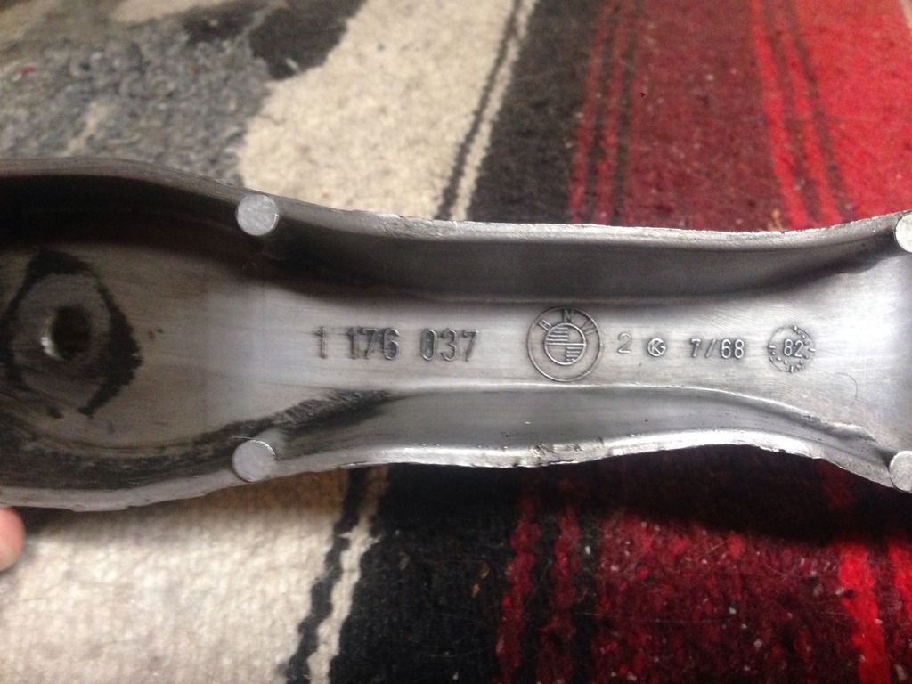

    Confused I looked up the part # that was stamped on the aluminum brace:
    And it turns out some PO had put a E24/E28 transmission cross member on this E30. When I put the correct piece on the car, it raised the transmission up by about 3/4" (19mm).

    Wow. Can't believe the holes in that output flange. Good thing the aluminum brace had a chunk missing otherwise you might have never figured this out.

        My thoughts exactly! Would have put the rebuilt driveshaft in and been scratching my head why it didn't fix the vibration!

              Good find Matt, I have never ever seen an output flange look like that or the wrong trans brace put on. They are so easy to pull and find at the yards.
              Freaking hacks I tell ya!
