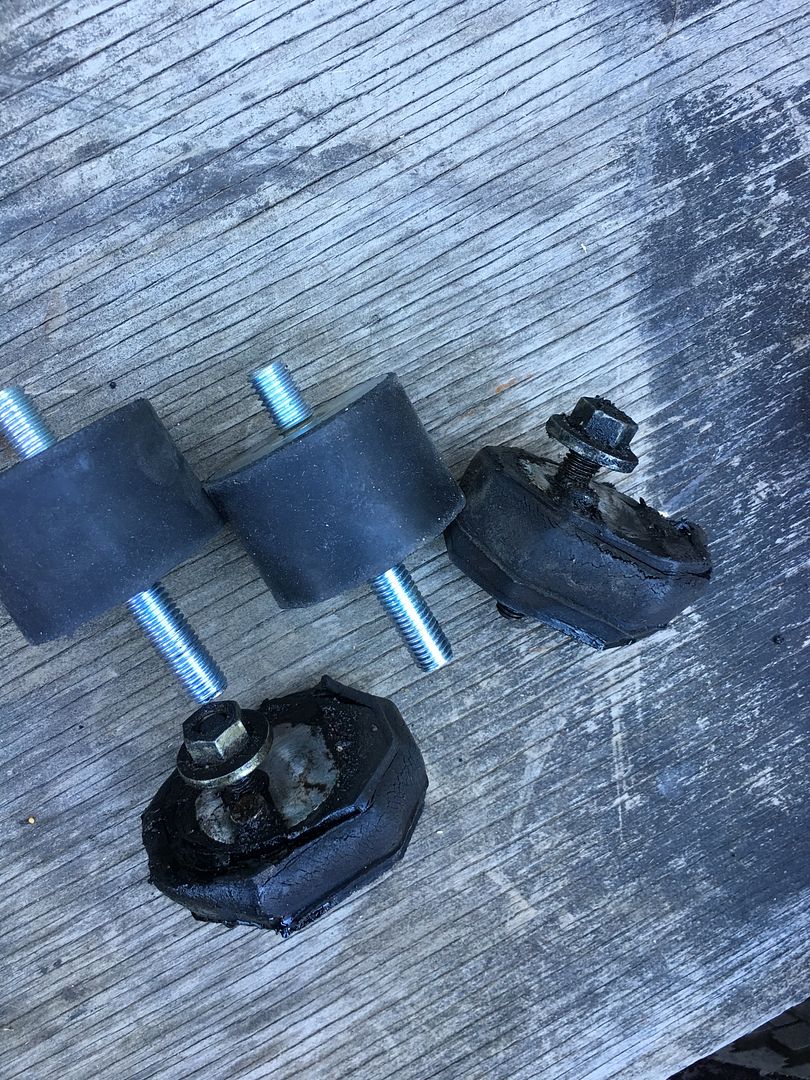

    Remove the old E30 Tranny mounts.
    *E21 mounts have bigger bolts on them

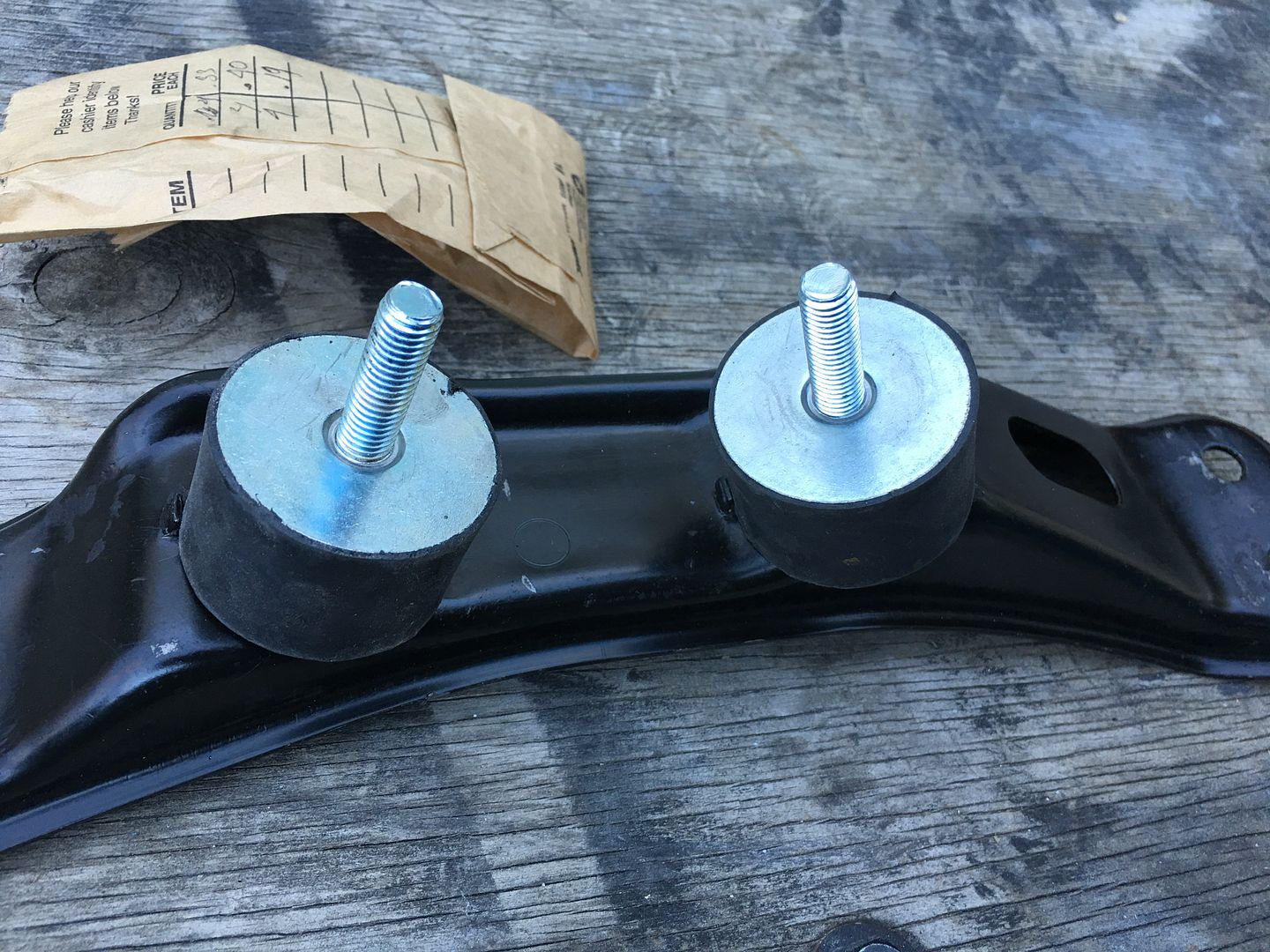

    Get a drill and a step drill bit and make a hole on the brace big enough for the E21 mounts to slide right in.

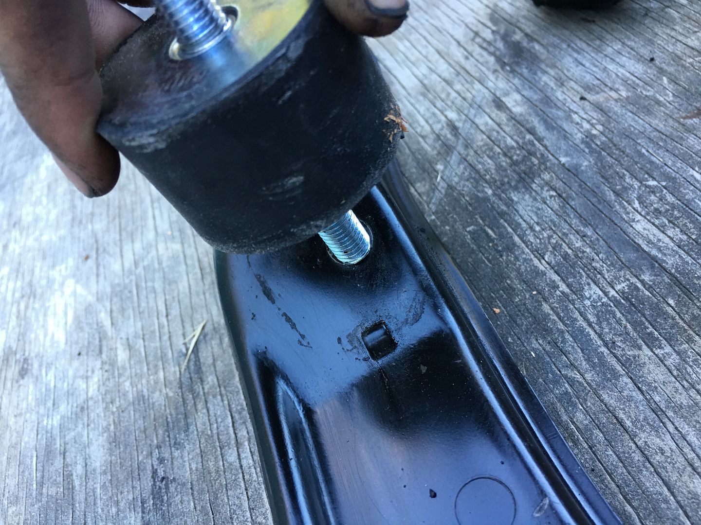

    Get your 10x1.5 nuts and some washers , 17mm
    Put the short bolt on top (it will be used to attach itself to the transmission)
    The long end bolt will be at the bottom.
    Get your nuts and washers and put them on the lower mount bolts and tighten them really good. 17mm
    *DONT MIND THE PICTURE, I HAD THE LONGER BOLTS ON TOP BUT THE INSTALL WILL HAVE THE SHORTER BOLTS ON TOP

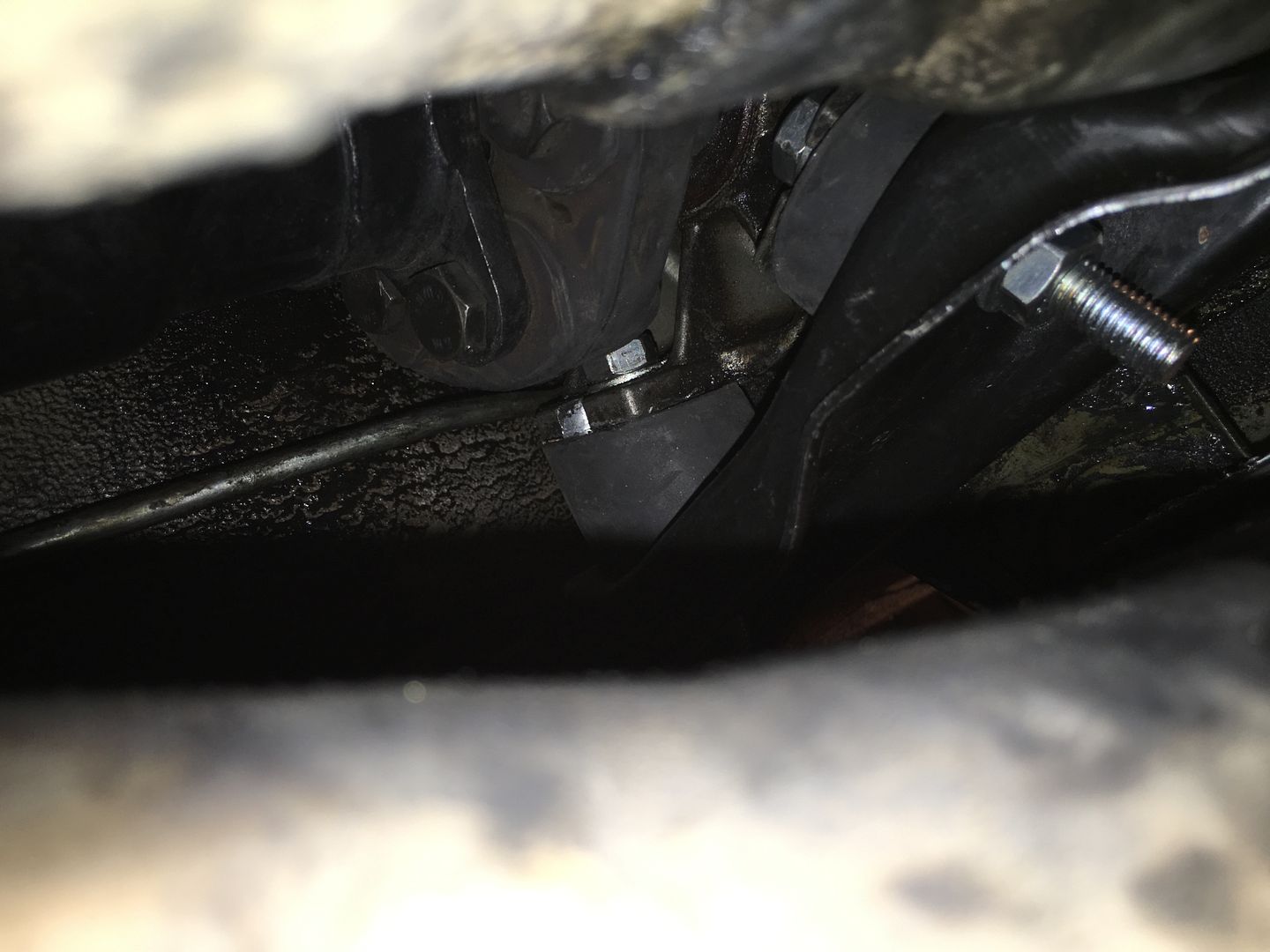

    Go under the car with your drill w/ step drill bit and where the tranny mounts attach to the transmission you will have to make holes for the E21 bolts to fit since their bigger.
    *I lowered the transmission more and let it sit on the exhaust while I made the wholes, It gave me more access.
    -Note: The passenger side will be awkward since the exhaust is in the way. I was able to make holes but I had to angle my drill and drill it at an angle, just make you sure you're accurate.
    While the tranny is resting on the exhaust, mount the E21 tranny mounts w/brace. Same thing, tighten them really good. The 10x1.5 nuts used a 17mm. The bolt did not go entirely through the nut. It went 85% - 90% all the way through the nut with a washer. TIGHTEN IT REALLY GOOD.

    My old tranny mounts were BAD so this is a HUGE difference when driving. Vibration is gone, and auto tranny shifts are way better. It doesn't jerk when it shifts anymore.

        They're better quality and design, a lot of people use them because they're thicker and more well built and sturdy. E30 tranny bushings don't have a great design and end up going bad faster.
