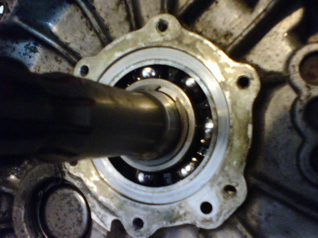

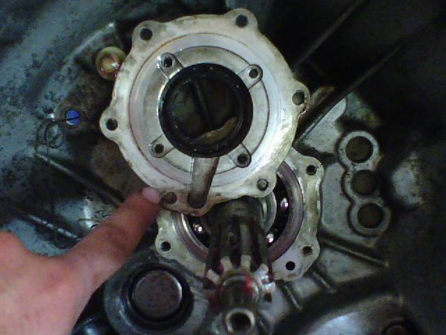

    Do I need some kind of paper based or cork based gasket that goes between this input seal carrier and the actual transmission? I have had a leak before and i'm not sure where it was from... so this time i want to make sure i'm doing this right..

    no, you need to use a sealant of some sort, I used regular loctite. BMW uses Curil K2.

      cool, thanx. I thought twice about putting it on dry

        yeah, I'm not sure how well the loctite works though.. mine isn't leaking from the front, but the output shaft leaks like crazy. I ordered some Curil K2 online to redo my output shaft with, I would reccomend getting it for your input shaft since you def. don't want to take that apart again!.
        and make sure you put it on all the bolt threads too
