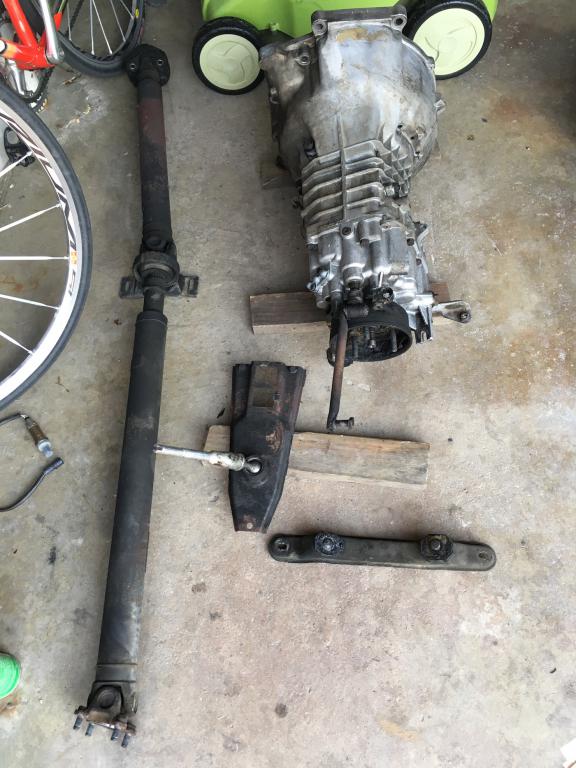

    I'm just going to list some questions about the manual swap and hardware as we work our way through this. We have an '86ES auto, right at the 5/86 crossover month. We bought an '84 1270 eta G260 which should have the single mass flywheel with sensor pins.
    First thing - it was in a car with an engine fire. The good thing is it was running and shifting. The bad thing is some odds and ends got hot, so we're checking into the condition of everything on it.

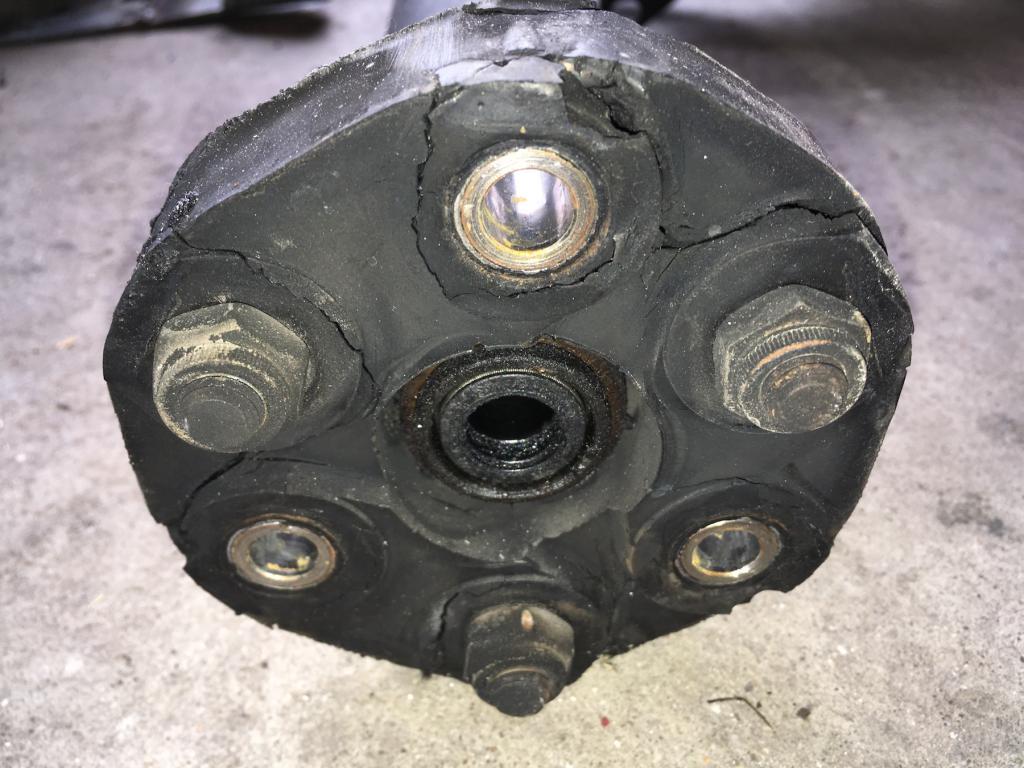

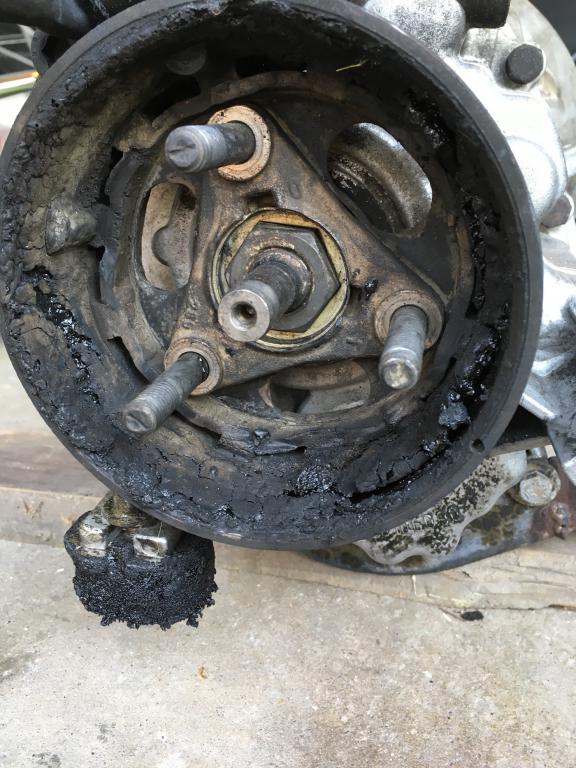

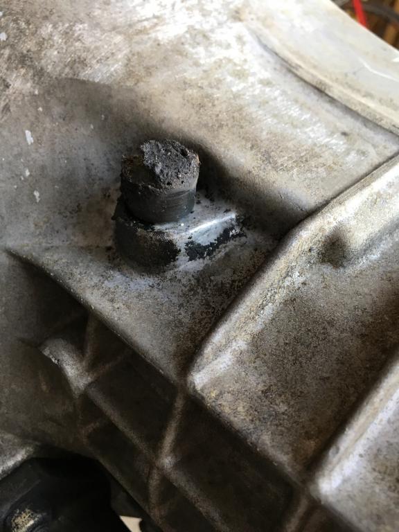

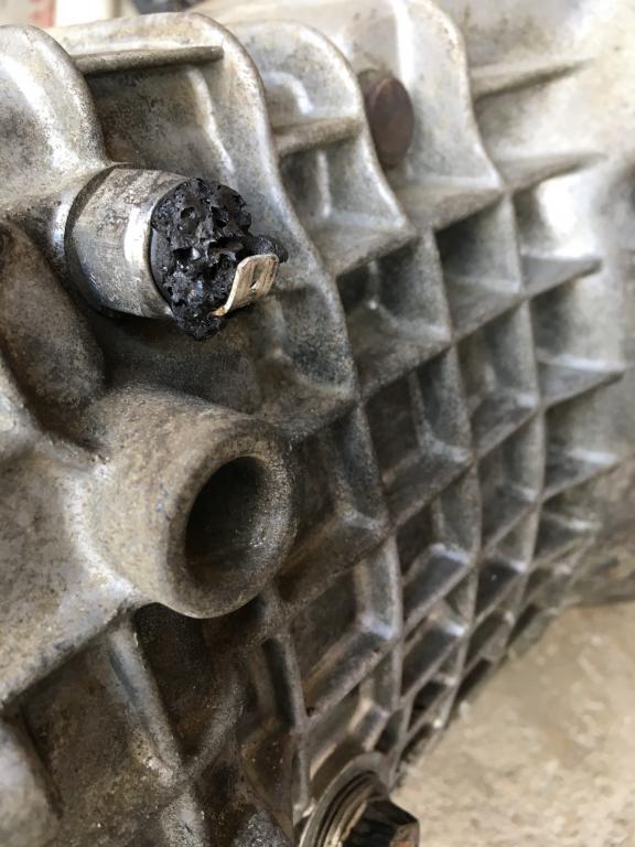

    My guess is a left side fuel fire that dripped onto the ground underneath...? CPS's are melted off. Vent cap is partially melted. Exterior switch is part melted. Guibo shows signs of being hot and starting to get gooey, and the vibration dampener looks like it was melting together. Rear trans mount on one side is sticky and soft.

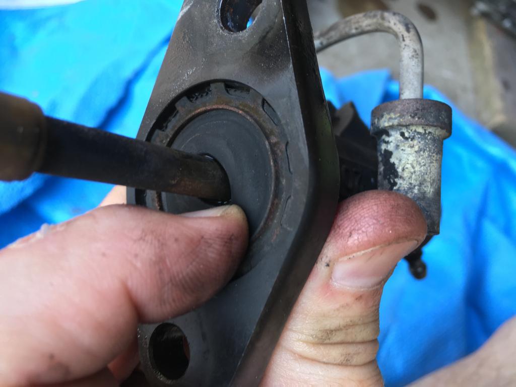

    BUT...the slave cylinder rubber is intact and good. The fork spring is fine, and that's pretty thin wire. So it was exterior rubber and plastic. We'll change all seals, even though it wasn't leaking.
    We got an intact driveshaft, cross-member, & plate shifter assembly.

    Slave was fine and still working - spring and rubber still good

    So, my questions so far before we start a parts order:
    1. Is this the small output flange?
    2. What's the deal with the vibration dampener at the output flange / guibo? Some cars have it, some don't? Is there a rhyme or reason? Only early cars? Is it necessary? Why is it over $200 new from BMW, and are there aftermarket ones? Do I need to find a good used one? Can we leave it off?
    3. Why do people replace the clutch fork? Seems like just heavy sheet metal. Does the TP bearing wear divots in it? We'll do new spring, pivot pin, pilot brg, TO brg, and of course clutch assembly.
    4. Any first-hand experience with heat on the exterior of the case?

    Hot guibo.....$5 shipped...

    I'm scraping the CPS bits out of the bores.

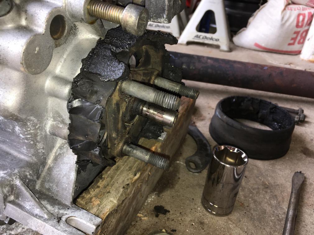

        1. Is that the small output flange?
        2. Do I need this vibration dampener on the output flange?

          1. That looks like the output flange on the eta trannies I've seen.
          2. It my understanding you can delete the damper. I dont have one on my 87 which uses an eta trans and drive shaft
          3. Wear. I'd say you have options here. I replaced mine cause I didnt have thje donor car with me when I ordered parts. They arent costly and nnot a big deal either way IMO

            I'm pretty sure it's the small one - need to order the correct guibo, the driveshaft matches.

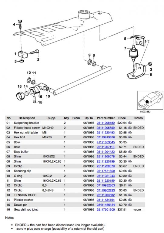

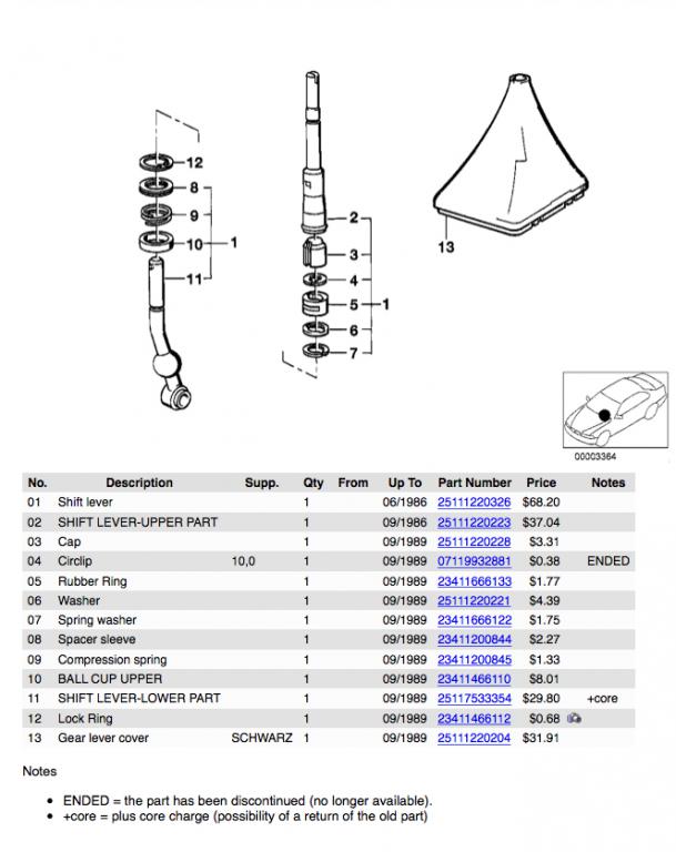

            On these OEM diagrams, does the stack of little bits inside the shifter arm need to be replaced for any reason? (3 4 5 6 7 8 9 10 12) It's all tight, no play in it. And you could replace it later from inside the car.
Name:	E30 shifter .jpg
            At the back of the shifter plate, it shows two brackets or rear mounts that attach to the body I think, #5 and #6. Are these already on an automatic car?

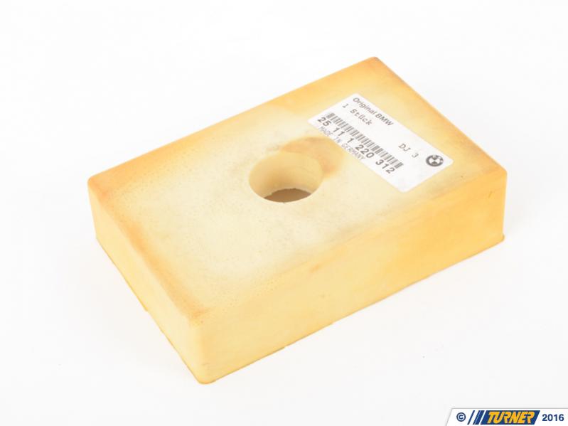

              Oh, and on the parts diagram it shows a "sound absorber" that sits around the shifter hole. I thought it was a rubber pad, but it's this sponge-looking block...
Name:	sound absorber.jpg
              Anyone find this when they pulled one apart? Was it still there? Is it foam?
              • jeffnhiscars
                • Jun 2011
                • 6011
                I have a piece of foam but it doesnt look like that. Im also wondering if you can just switch to a late style shifter and still have everything mount and line up. It all looks compatible

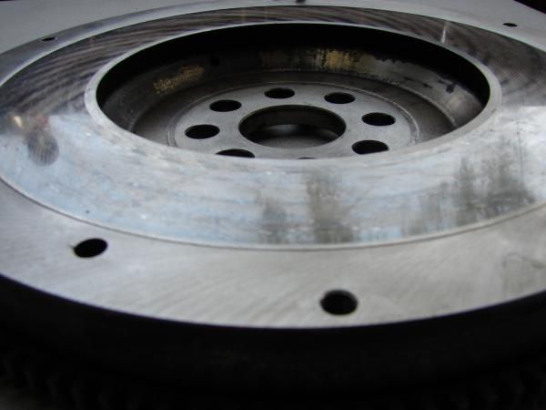

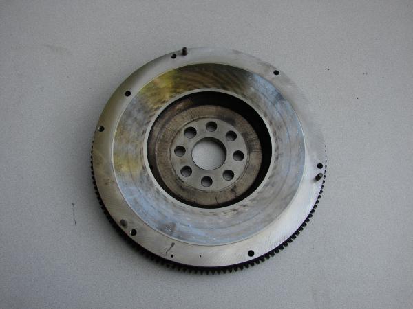

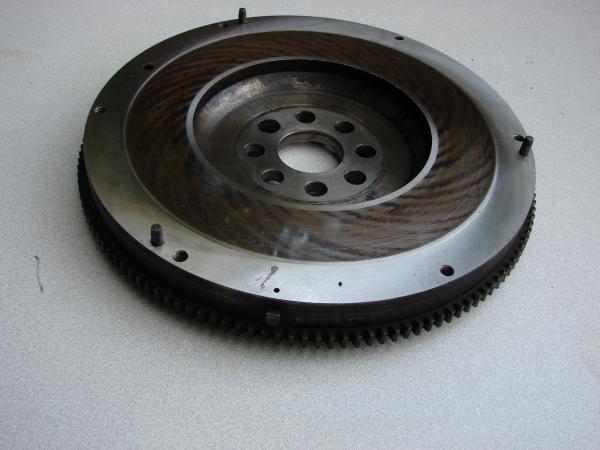

                      Opinions on this flywheel surface please?
                      • jeffnhiscars
                        • Jun 2011
                        • 6011
                        It looks smooth and unscored but I see flywheels like brake rotors. Its a friction surface that needs to bed with its new disc (or pad) so texture matters.

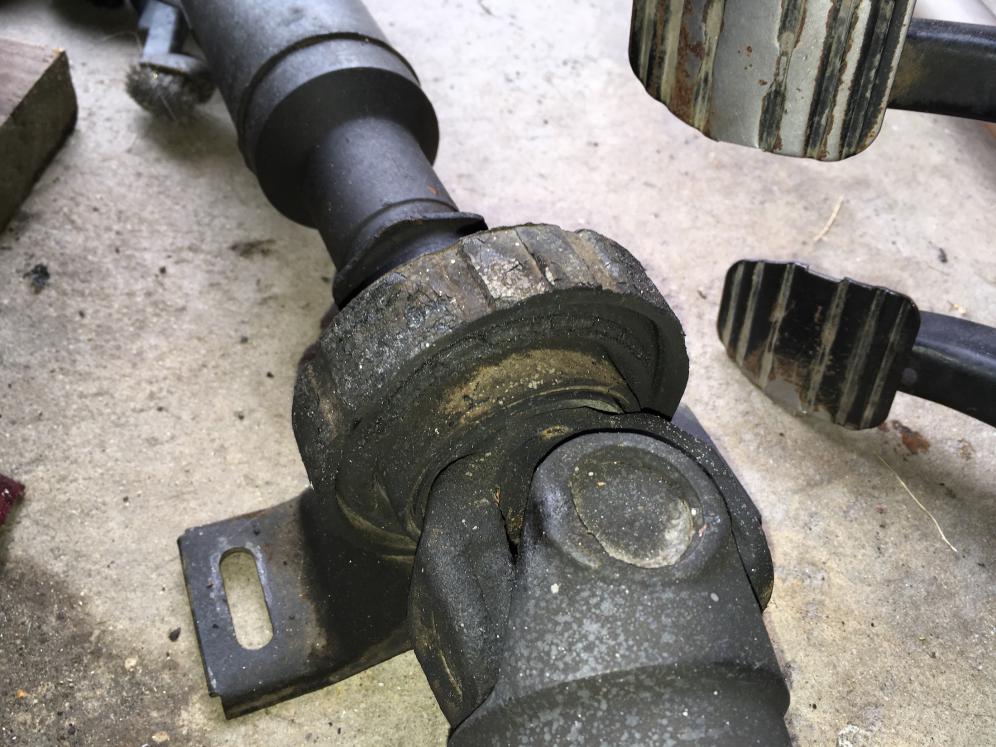

                          Things got a little warm.
                          This will all be rebuilt with new. Mostly just soot and crud. The u-joint feels solid, no play.....opinions on replacing?

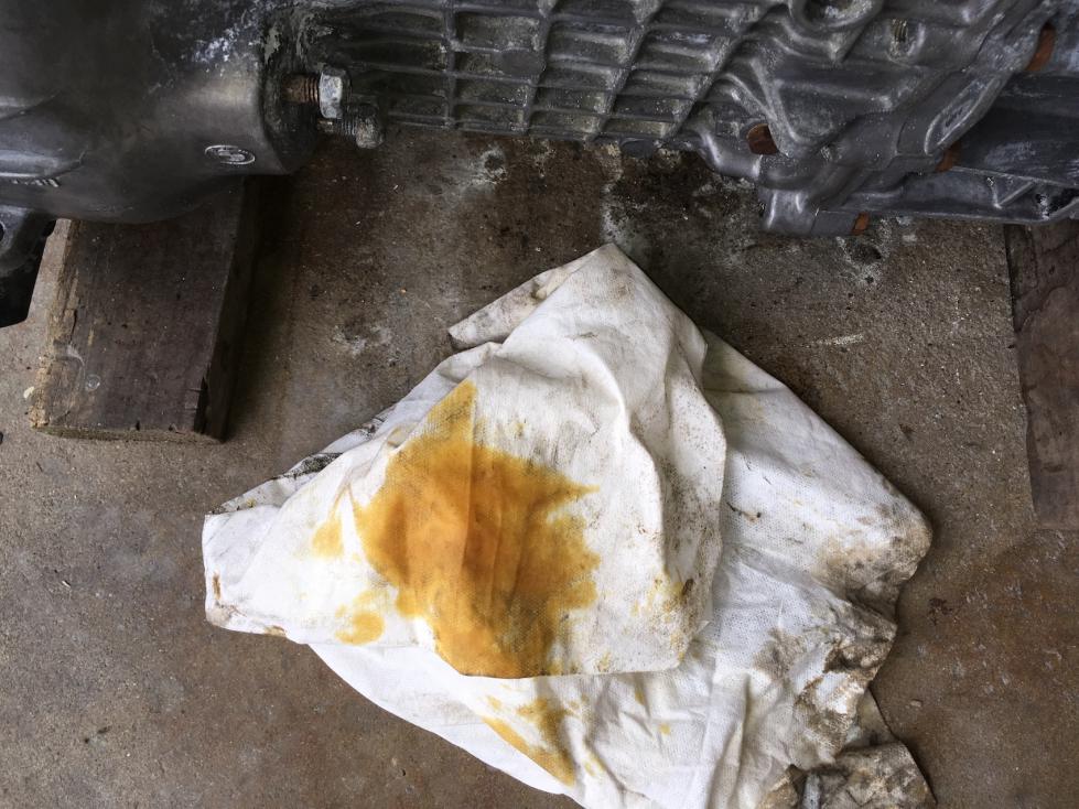

                          I drained some of the oil and it looks good, smells fine.

                          I cut off the steel ring on the harmonic balancer at the output flange. Are you guys sure this can be left out when we're finished?

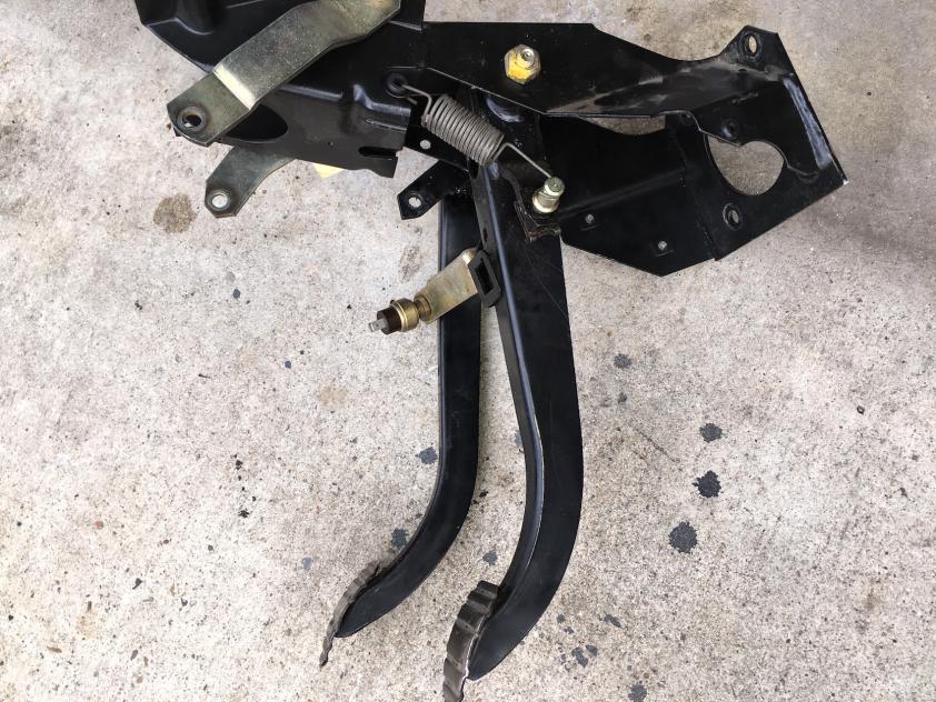

                          • LateFan
                            • May 2013
                            • 4408

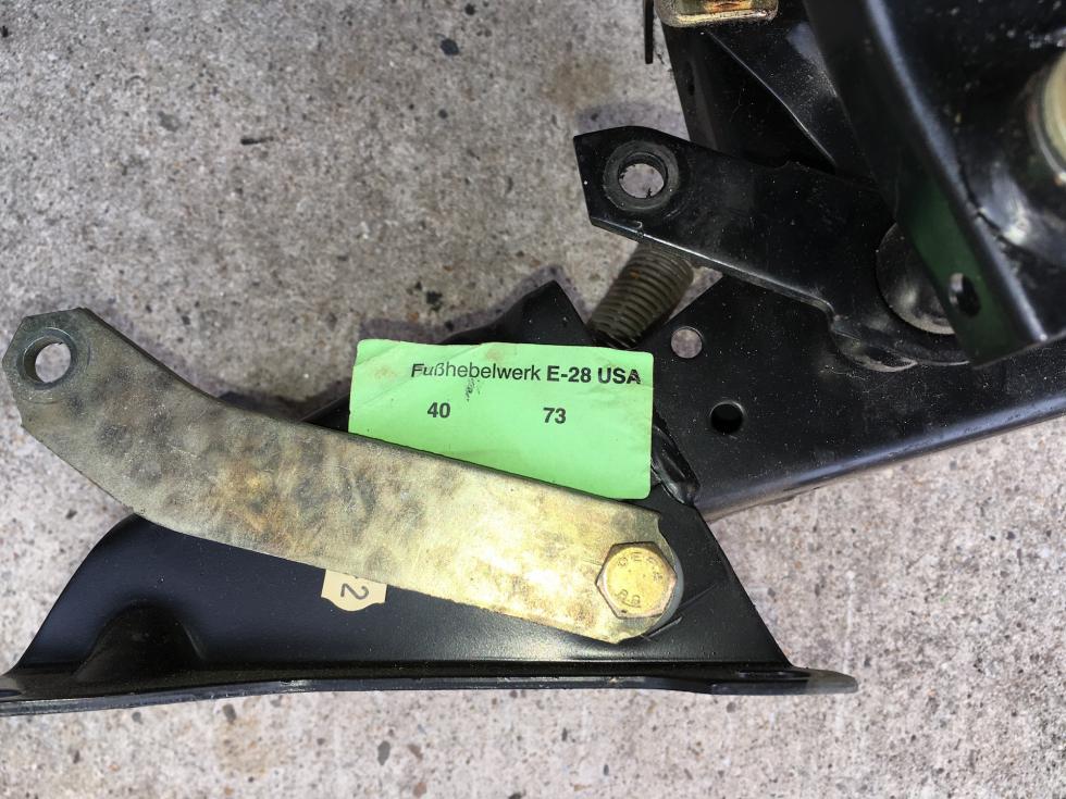

                            The pedals we got have an E28 sticker, but I assume those are the same piece?
                            These pedals should eventually rest in the same plane, correct? Or does that zinc-plated bar just needs some adjustment?
                            • jeffnhiscars
                              • Jun 2011
                              • 6011
                              My clutch pedal is about 1/2-3/4" higher & as long as your u joints are tight and not lumpy they should be fine. New guibo and CSB goes without saying (which is why Im saying it) :-)
