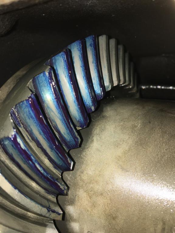

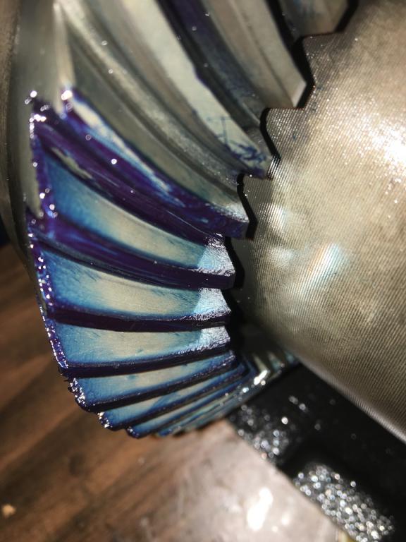

    I am doing a backlash adjustment and this is what I came up with so far on the drive side and the coast side.
    Is this acceptable? Any advise will be appreciated.
    The spec tolerance is .0045" I can probably bring it down to .003"+ given the shims I have on hand.

    those contact patterns look ok to me...
